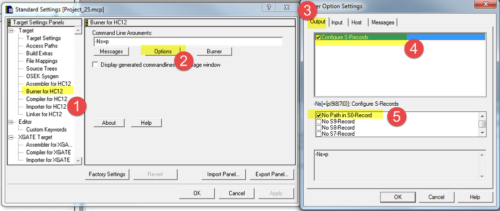

i would like to know how to generate a glo file with no project path line.
The purpose is to get the exact same binary file wherever I compile it.

if you use CW for HCS12(x), to remove path from s0 record, please follow below steps in project setting.
can this help you? if not, please port your question here. thanks.

Hi Jennie,
thank you for the fast reply.
This answers the question.
