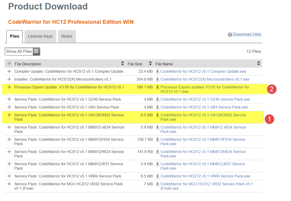

I am using the S9S12GNA16F0MLF model and I am using Freescale CodeWarrior 5.9.0 version.
I tried to select MC9S12GNA16F0MLF as the picture below, but I can't use it because it is not in the list. Because ADC12bit has to be used, it cannot be developed with MC9S12GN16F0MLF.
Please let me know how you can add or update MC9S12GNA16F0MLF to the list.
Thanks.
4,437 Views
ZhangJennie
Hi Seok Kim
Please make sure you use CW5.1 with GA patch and PE update.
Then follow attached video to select the right package
