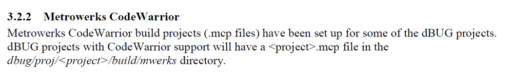

I checked the dBUG firmware development file, which mentioned there provides a dBUG project based on CodeWarrior IDE:
If customer could find related dBUG project and using that project to do the porting work.
I attached  dBUG firmware development file for your reference.

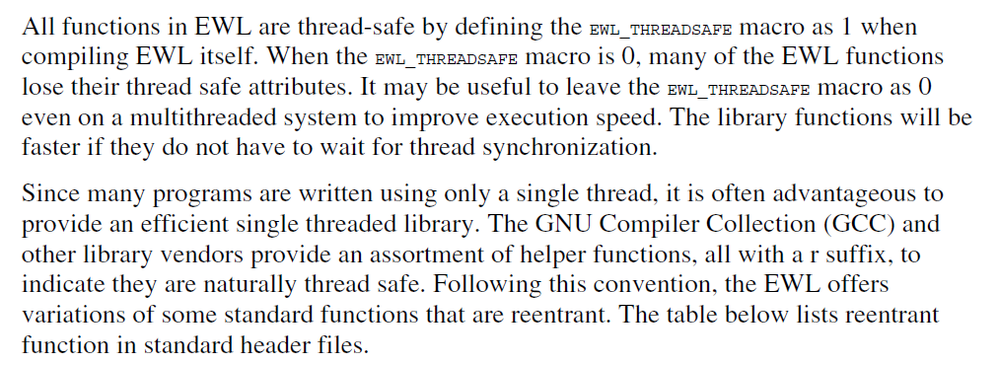

The CodeWarrior C and C++ compilers use the Embedded Warrior Library (EWL) for C to provide and extend the libraries documented in the ISO/IEC standards for C.
I checked there with below description about reentrant Functions from EWL C Reference Manual:
Please check if EWL library affected GCC call related functions.
