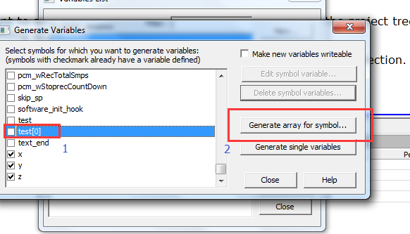

I tried to generate the visualization of two-dimensional array variables in Freemaster 2.0.0.10 and in 2.0.2, but this is not possible.
I already use the same two-dimensional array in Fremaster 1.3 and it can show the array correctly.
How can I visualize a two dimensional array in Freemaster 2.0?

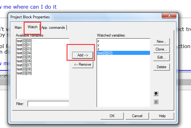

Hello Mirko,
Yes, there is some difference between the two version.
In Freemater v2.0,  for example i define a two-dimensional array variables test[2][2];
Please refer to the screenshots below :
This process add the test[0][2] to watch.
Hope it helps
Hope it helps
Alice Yang

Yes, I solved using your suggestion.
In detail... I created an array for each single element of the first index of the array.
In my opinion the method offered by Freemaster 1.3 is more "user friendly", anyway the workaround suggested properly solve the problem.
