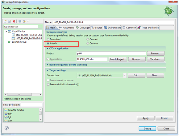

I'm using CW 10.6.4 for the MC9S08DZ32 MCU connected via multilink to a prototype board. I can download the .abs file to the board and debug all day long. But when try to load the flash .s19 file using the "Flash File To Target" window, it seems to go alright and doesn't report any errors but when I reset the target board, it does not run.

Not sure why "Attach" button is grey on your side. please create a new project with wizard and see if this is a common issue for all your project or just for a specific project.

Thank you for your reply. The clock trim issue sounds like a possible solution but how do I correct that? BTW, my "Create, manage, and run configurations" window shows the "Attach" button greyed out and I cannot select it.
