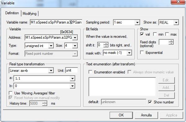

I faced a problem with Freemaster 2.0.2 using transformed variables.
The FMSTR project used is attached. I use Freemaster ver. 2.0.2.4 (comm.protocol v3+). The target is connected with a serial link.
You'll se two representation of the same variable (an ACC32 viewed as INT32): the first is real-transformed and multiplied by 3.051758e-5 to ease reading/writing; the last is showed as DEC.
Steps causing the error are the following: i try to write a number (e.g. "9" or something decimal "9.1") to the real-transformed variable and Freemaster says "Could not translate value back to its raw format" (see image no.2).
But if I change the decimal-viewed variable all is ok: in the example i changed it from 327681 to 317681 and the real-transformed one correctly changed from "10" to "9.69486" (see image no.3).
I experienced the same error even with INT16 or Frac16 variable viewed as REAL.

If I understood correctly, modifications made to a real-transformed variable are not allowed (Freemaster prompts an error message about being unable to translate value back to its raw format), right?
How did you define your variables?

agostinofacotti
Hi Isaac,
sorry for the late response;
You're right! Your setttings are correct;
I've tested your solution on the same project and with float no problems arise.
I declared the variable as follows:
acc32_t a32PGain;‍
Testing again I Found that my problem arises when i try to modify variables viewed as integer (32 or 16 bit) and than transformed as shown in the following picture:Variable property.jpgIn this case i noted that I can still write to the variable values as 0, 1.1, 2.2, 4.4, 8.8, 17.6 ecc.. seems all multiples of a but not any other numbers.
E.g. i can write to a32PGain the value 169.4 (169.4=1.1*154) but not the value 170.
I tried the same strategy above with the coefficent a = 3.01758e-5 and I confirm I can write values as 3.01758e-5, 6.03516e-5 (=2*3.01758e-5) but not numbers in the middle.
It seems that Freemaster doesn't know how to round numbers and accepts only multiple of the multiplier a
