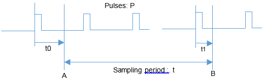

I have K60 Towerboard, _K60P144M150SF3RM, with MQX4.2, and CodeWarrior 10.6.4.
In your Application note AN5083 detailed the approach to measure frequency using DMA. Basically it sets a DMA channel for frequency input, uses counters(CITER, BITER) to count pulses. The frequency can be calculated with total pulses over some period of time.
But for application needs more instantaneously measurements with smaller sampling time, such as 10ms, 30ms sampling time, then there is an issue. For better accuracy, the counter values transferred by DMA on both ends for the sampling duration need to be incorporated into the calculation of the frequency for this period.
The frequency can be calculated as Freq = Pulses / Sampling Period .
But the issue is the sampling period, for high resolution of measurements, a free run timer has higher frequency (1.8Mhz), then within the sampling period AB, it may contains a number of overflows of the free run timer. To determine the number of overflows is difficult due to the race conditions between the free run time overflow (wrapping) and the DMA. (t1 ===> 0) . What is the best way to resolve it ?

Currently I have implemented the frequency measurement using DMA. It works well. The issue I reported can be resolved. I think with interrupt to resolve hardware racing issue will be a better way.
The approach you proposed is also a good way. I want to point out two differences:
1. Frequency can be calculate at the ISR of capture. That means the sampling time is variant. At higher end of 500KHz, ISR calls too often. It becomes a burden for CPU. with DMA approach, the sampling time can be fixed. The ISR is free timer, not the external signal edges. That way the CPU cost is even and adjustable.
2. To fix the sampling time duration using FTM, then the two approaches will be essentially the same. There will have the same issue of FTM as DMA. At the time to calculate the frequency, FTM_CnV may be just in updating. In other words, there is a racing condition between the ISR of the sampling period and FTM_CnV interrupt. So the question will be: is there a way that in the ISR of the sampling to prevent FTM_CnV from updating until the frequency calculation is completed for this sampling period.
