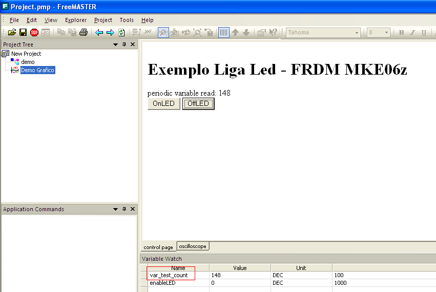

                Is it possible to execute a VBS script with reference to FreeMASTER's invisible ActiveX control OUTSIDE of FreeMaster? I want to to execute FreeMASTER commands from the command line just by executing VBS scripts.

1 - Run the project in freeMaster
2 - Create .vbs file in the work area as follows:
Option Explicit
'On Error Resume Next
Dim FMObj
Dim succ
Dim tValue
Dim vValue
Dim bsRetMsg
tValue = 0
Set FMObj = CreateObject("MCB.PCM")
succ = FMObj.ReadVariable("var_test_count", vValue, tValue, bsRetMsg)
WScript.Echo tValue
WScript.Quit
In my case saved as teste.vbs
Note that this very similar to yours.
3 - Run the .vbs file and in my case the result was:
See if that helps.

                   Thanks for your reply it gave me some hints. I'm using this code and I execute it with
CSCRIPT.
Option Explicit
Dim FMObj
Dim succ
succ = FMObj.ReadVariable("Speed", vValue, tValue, bsRetMsg)
WScript.Echo tValue
WScript.Quit
However I am getting an error message. Microsoft VBScript runtime error: ActiveX component can't create object: 'MCB.PCM'
I got the ActiveX object name from Chapter 6.1 after reading Chapter 6. Any ideas what is the right way to call the ActiveX from a VBS Script?

Thanks for the reply Jeferson.  I am using windows10 and I tried with the given code by you then it executed it. It shows an error " teste.vbs(11, 1) Microsoft VBScript runtime error: ActiveX component can't create object: 'MCB.PCM'".  Please let me know what can be the probable solution for this now. I am using windows10
Thanks in advance.
4,657件の閲覧回数
jefersonip
I do not have windows 10 for testing, but a look at the link below can help you.
http://stackoverflow.com/questions/656934/activex-component-cant-create-object
