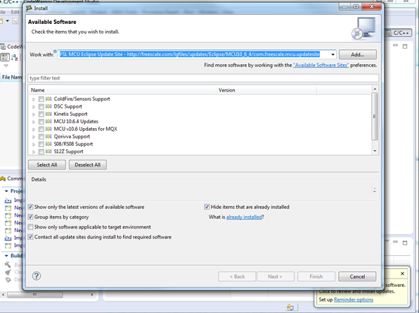

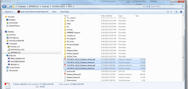

trytohelp
Hi Hiroyoshi-san,
Now, the Update 6 has been released.
To install it you need to launch Eclipse and click on Help + Install New Software ...
Select the generic:
    FSL MCU Eclipse Update Site - http://freescale.com/lgfiles/updates/Eclipse/MCU10_6_4/com.freescale.mcu.updatesite
to be sure you can run it 2 times.
After that you can launch the Help + Check for Updates too.
Under the installation, at then end you will see release notes under \CW MCU v10.6.4\MCU.
for instance:
Pascal
NXP Technical Support
