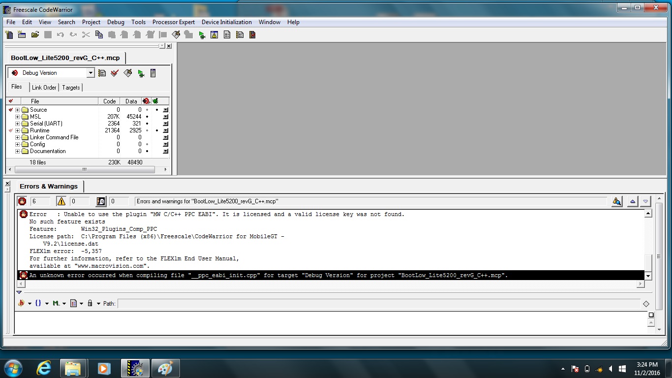

evanlim
Hi Pascal,
Are you referring to this? I had found “codewarrior(examples)” inside the CodeWarrior for mobileGT V9.2 folder.
I cannot click on build, so went to debug “BootLow_Lite5200revG_C” and it shows 6 errors(Attached files.).
I’m using window 7. MPC5200.
It’s not on the actual target board.
Till now, I just connected CW TAP to the target board, power on and try out Flash Programmer and Hardware diagnostic.
May I know which pin on the CW TAP probe is the supply voltage? Would like to check if the target board powering the correct voltage to the CW TAP.

trytohelp
Evan,
To create a sample example please do the following:
    - launch IDE,
    - File + New and select "EPPC New Project wizard", giva a project name, define path location and click on next
    - Select Freescale PowerPC EABI Linker and click on next,
    - Select device and click on next,
    - C and next,
    - select Interface - CW Tap will be listed if you created a new interface as explained in the AN4780 and click on finish.
Now the project wizard will create a very short example without lot of code.
build it and try to launch the debug.
I will send you a temp license to be able to use the Build tool chain and debugger.
