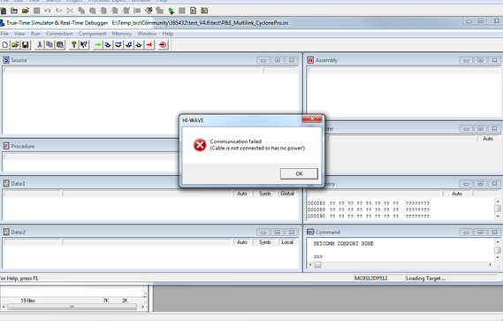

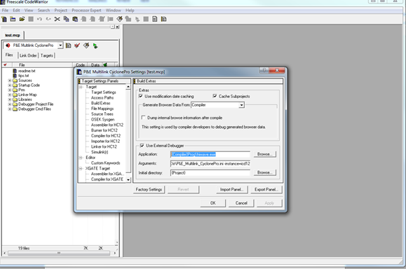

I've re-installed CW for HC12 v4.6 on my Win 7 64 bit OS.
After to have build the project I've tried to launch the debugger.
You can got an error when the debugger is launched.
In some case you need to re-specifiy the path of debugger tool:
On my side I got some errors when I launch the debugger and the application is not loaded.
    Similar project using same configuration (Hardware) is working fine with HC12 V5.1
Is there a problem with the P&E plugins used on HC12 V4.6 ?
    Refer to: P&E Microcomputer Systems: Over 30 years as an Industry leader in Embedded Systems Development Tools...
Download the  Patch for (S)12(X) 3rd Party Software, unzip it and refer to the readme.txt file.
On my side I backup the \Codewarrior for HC12 V4.6\Prog folder and extracted all files contained in the downloaded zip file.
After that I was able to launch the debug session and download the code on board using my P&E USBMultilink interface.

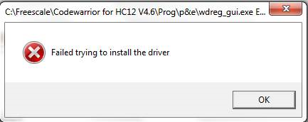

Sometimes ago I've performed some installation test see below:

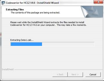

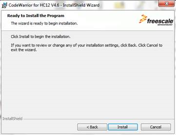

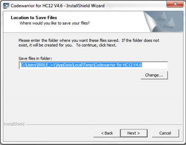

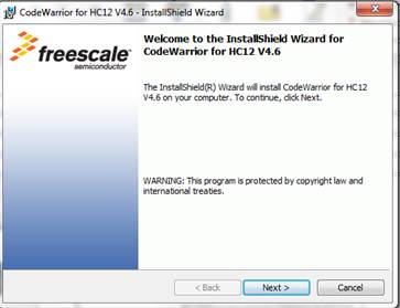

  1. A- Try to install HC12 V4.6 using default installer configuration
Launch the CW12_V4_6.exe
Next
  Next
    and

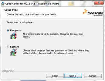

  Next + Next + Next + Next
  Select Complete and click on Next + Next and
  Install

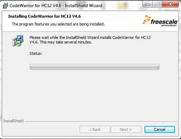

The installation is launched.

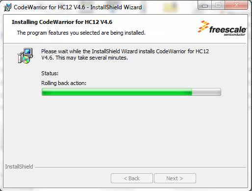

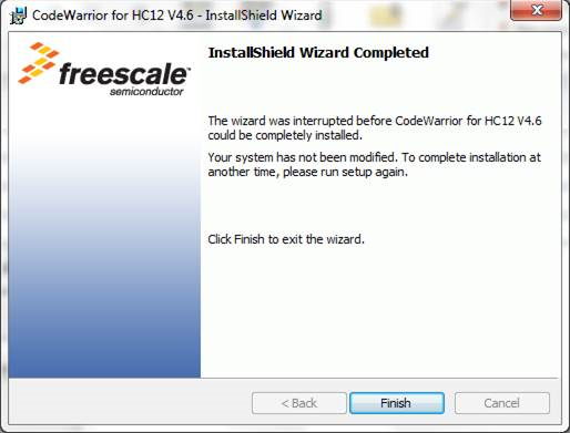

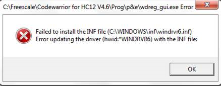

An error message appears
  This is linked to a driver issue (P&E)
Click on OK and a second message
Click on OK
Click on OK
The installation is rolling back
And …
  The tool is not installed.

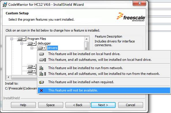

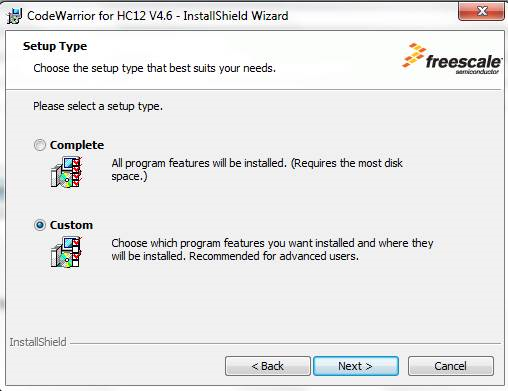

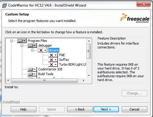

  1. B- Try to install HC12 V4.6 using specific installer configuration
Executed exactly the same process excepted for the Setup type, select custom
Next
Remove the driver from installer
Click on Next + Next + install

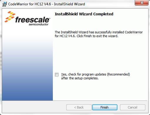

CW for HC12 V4.6 is now installed
Finish

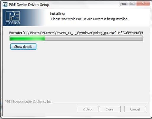

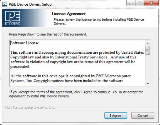

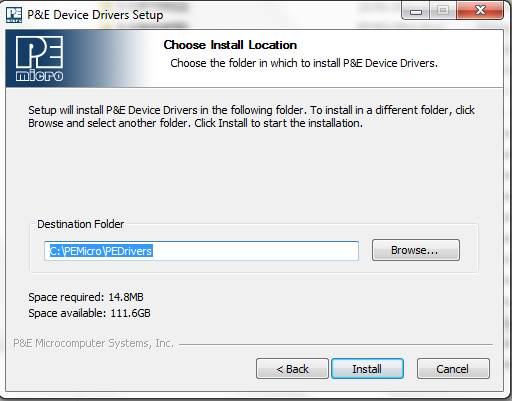

  1. C- Install new P&E drivers
Go to the P&E web site:
http://www.pemicro.com/products/product_viewDetails.cfm?product_id=33
Click on FAQs, Manuals & Downloads Tab
Under Download select: P&E Hardware Interface Drivers, Version 11 (Win XP/Vista/7/8)
PEDrivers_install.exe
Launch the installer
P&E drivers are installed.
