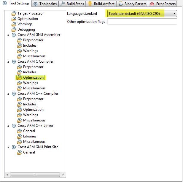

I am trying to work on TSS library for KL46 board using new KDS+PE tool.
I just added TSS_Library module and assigned PTB16, PTB17 for electrodes and ‘Aslider’ as control type.
I Generate the code and After cleaning i builded but getting below errors.
Is there any working example projects in KDS+PE for slider in KDS for KL46.

Hello Bheema,
I have it working on my side for the FRDM-KL25Z (I do not have a KL46Z at hand right now). See Tutorial: Touching the Freedom KL25Z Board | MCU on Eclipse about the project setup (for CodeWarrior). I have attached for you my KDS project (you find as well on GitHub: mcuoneclipse/Examples/KDS/FRDM-KL25Z/KL25Z_Touch at master · ErichStyger/mcuoneclipse · GitHub).
There are two differences between KDS and CodeWarrior:
  1. Add the TSS library to the linker options
  2. Change compiler option to accept asm("...")
1. Linker library: add the TSS library and path to the project settings
2. Change the compiler language so it accepts the assembly syntax used in the TSS library:
With this, things should work on your end too.
I hope this helps,
Erich

kyizawwin
Hi Erich,
It works for my KL05Z too. Thanks!
Bryan
