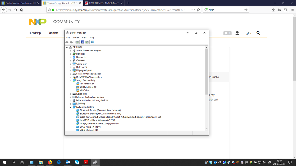

I connected an S9S12GA128 uC to the Multilink Universal FX debugger and installed a CodeWarrior CWS12v5.2 on my W10 Op.Sys in order to flash it. The PC has not recognized the debugger appropriate because in the device manager can any exclamation marks be seen. I did any times driver update but the situation is the same:

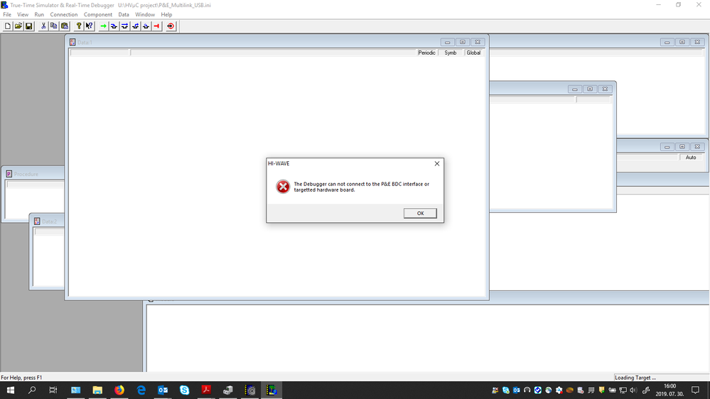

In CodeWarrior after loading Projekt File and doing 'Debug' there is next message coming:
What would you recommend to do ?

Hello Laszlo,
Please try to install latest PEmicro drivers
http://www.pemicro.com/downloads/download_file.cfm?download_id=53
and firmware for S12(X) :
http://www.pemicro.com/downloads/download_file.cfm?download_id=346

thanks for the suggestions, in the end the firmware update has helped.
The new device 'pemicrowindrvr' in Jungo appeared and the exclamation marks disappeared except WinDriver in the Device Manager, see below:
It was possible to flash the uC.
