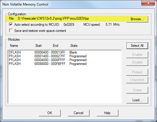

I installed the Code Warrior 5.2 Missing pieces files and everything seems to work ok except for an issue with a parameter file for a H-Wave debugger.
Error Message: "Hi wave Parameter File Could Not Be Loaded" I don't use this debugger so it should not be an issue, but are there any updates for those that might.

Hi Tim
What chip do you working with?
One possible reason is that your CW project didn't use correct fpp file.
Different chip uses different algorithm file (*.fpp). You can check it in debugger menu "H12MultilikCyclonePro", "Flash"
Jennie Zhang
