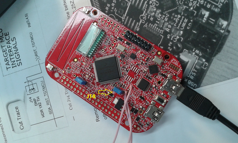

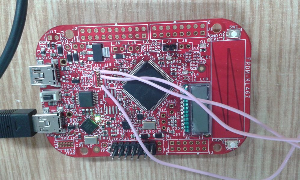

I am trying to connect kl46z256 to Code Warrior v11. I have gone through different online suggestions to change the kl46z to debug mode but the error comes when the Code Warrior is trying to connect to the hardware. The attached pictures show the problem.
My operating system is Windows 7. and the hardware works when I copy and paste the code to it but not when I use debugging.
Any suggestions?

I found the problem J18 was disconnected and I just put a pin. Since somebody gave me the board I did not know about it.
Bee Zee

beezee
I have managed to install the firmware you uploaded, and I created a new workspace. I still get this same error however. Do you have any further advice for solving this problem?
