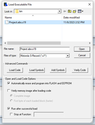

Jeevan
Hi @ZhangJennie ,
We have installed the licensed version of Codewarrior (5.9.0)

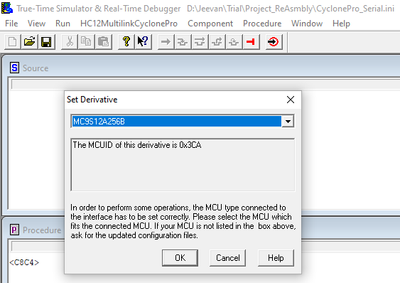

Step 1: Under Component tab in the “set connection” we have selected HC12 and P&E Multilink/Cyclone Pro.
Step 2: Under HC12MultiinkCyclonePro tab we have selected the derivative as "MC9S12A256B"
Step 3: Under HC12MultiinkCyclonePro tab in the communication tab we have configured as below

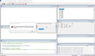

Step 4: Finally under the “File” tab and selecting the “Load application” tab we are Import the below .s19 file into debugger.
Final Conclusion: The below error is comming in the Hi-Wave simulator application while loading the binary to flash the MC9S12A256 controller

ZhangJennie

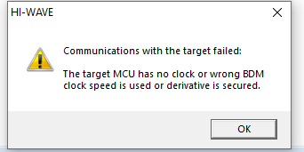

Jeevan
Hi @ZhangJennie ,

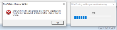

I tried creating a new project and tried connecting to the device, but still its throwing below error

ZhangJennie
The error message shows this part is secured.
Please unsecure it with Unsecure_12 from this link.
https://www.pemicro.com/downloads/download_file.cfm?download_id=16
Hope this helps.
Jun Zhang

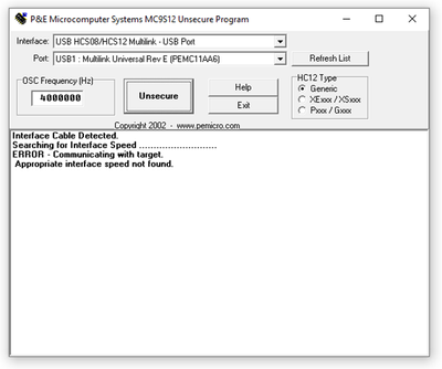

Jeevan
Hi @ZhangJennie ,
I tried downloading and installing the Unsecure12 utility tool also with the PE micro's "USB-ML-UNIVERSAL" But still its unable to connect with the Target controller "MC9S12A256".
Kindly please suggest a solution to unsecure the device or to flash the binary to the controller.

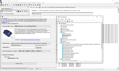

ZhangJennie
The problem may be either on multilink universial or target baord.
I suggest you testing multilink universial with another 8bit or 16bit board to identify if multilink is good for use?

In the Hi-wave simulator tool we are not able to select the exact part number of our controller which is "MC9S12A256", instead of this we are getting the part number "MC9S12A256B" even after adding the patch sent in one of the query asked in NXP forum.
Are both "MC9S12A256" and "MC9S12A256B" the same or different as we are getting the below error when using the multilink universal debugger.

ZhangJennie
CW IDE with MC9S12A256B can also connect MC9S12A256.
If your board can't be connected with IDE and P&E unsecure tool, you need to check if your part is still in good condition. Please test the same with another part to verify it.

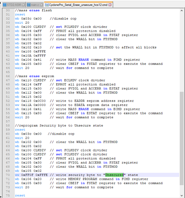

Jeevan
Hi @ZhangJennie ,

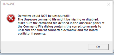

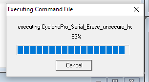

I am trying to unsecure the controller by giving value 0xFFFE at address 0xFF0F as mentioned in the below mentioned NXP document (Page 3).
Link: https://www.nxp.com.cn/docs/en/application-note/AN2880.pdf
The process is going upto 96% as shown below
Then its throwing the below error as it cant be unsecured
Note: I am trying to unsecure the controller using the Hi-wave utility tool of code warrior and executing the below mentioned .cmd file

ZhangJennie
As I said,you need to check if your part is still in good condition. Please test the same with another part to verify it. Thus we can identify the problem is caused by toolchain or part damaged.
