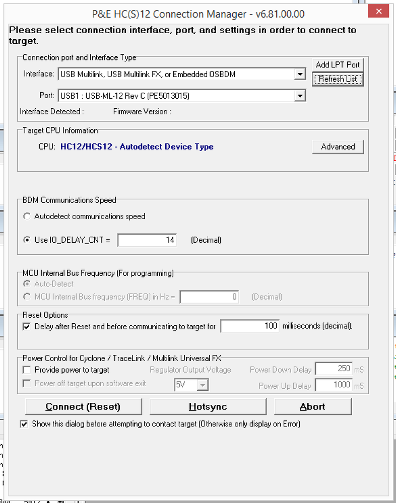

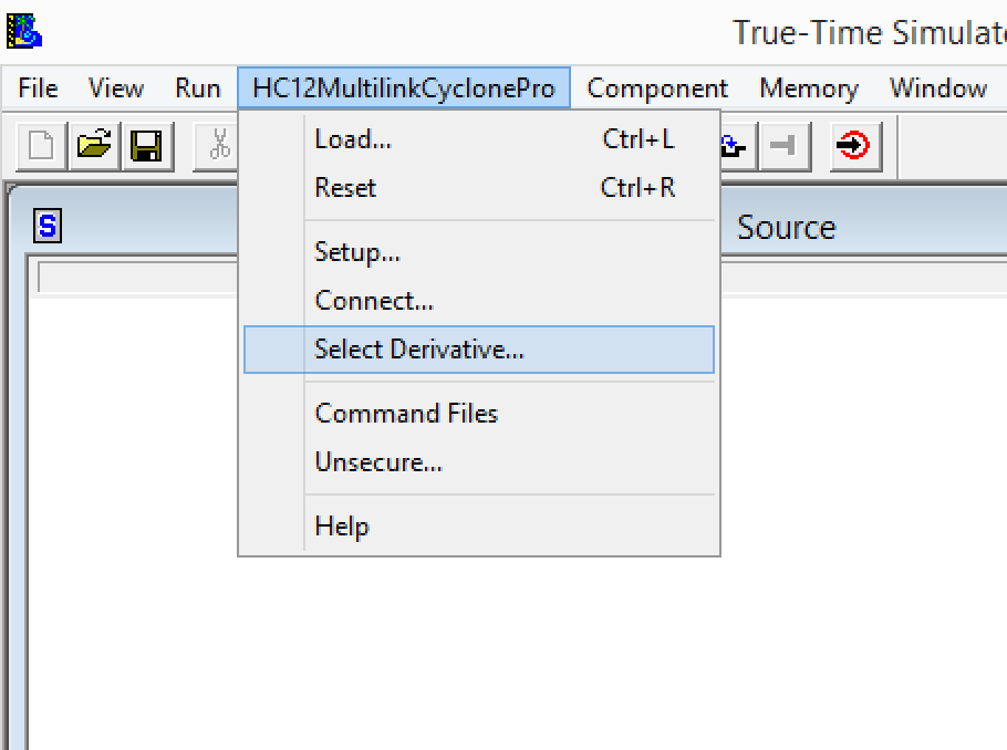

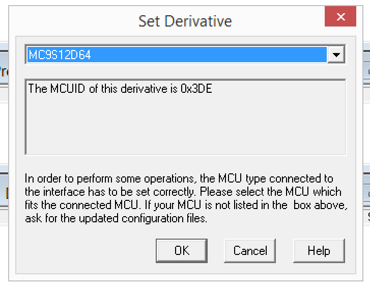

In the debugger what do you see under?
HC12MultilinkCylonePro -> Select Derivative
When you dragged in the files from the zip, did you overwrite ALL existing files?
What P&E debugger do you have, model and revision?
Did you install the latest P&E USB driver?
This is what mine looks like.
If you goto
HC12MultilinkCylonePro -> Connect what does it look like?
It should look like this including the text in the title bar of the subwindow.

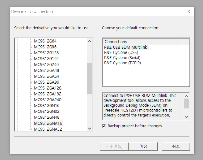

s_kim1

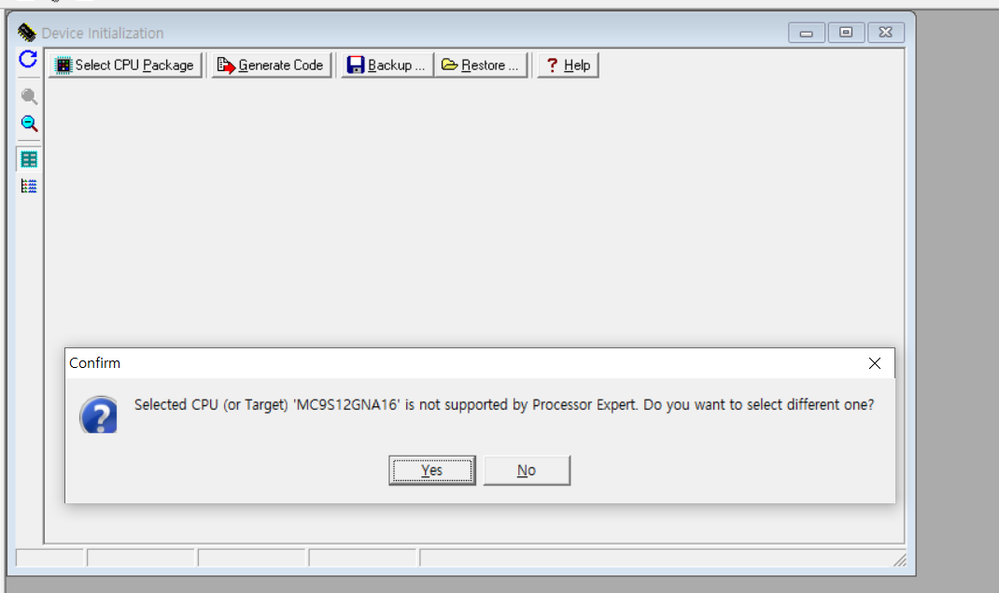

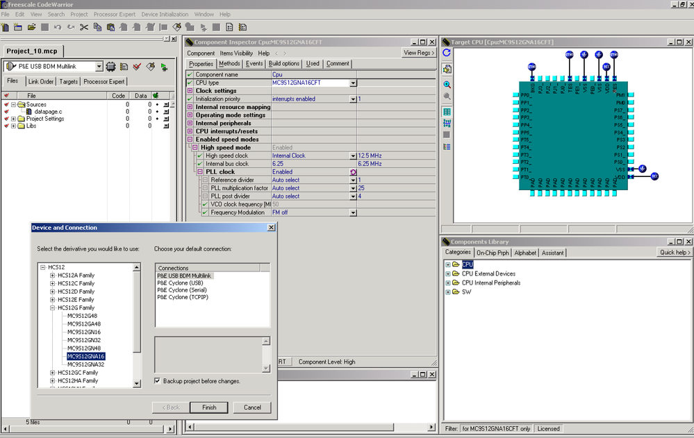

Hello
I read the post well. This content was very helpful, but there is one problem.
As I tried to do Device Initialization, there is no device to use.
I will use MC9S12GNA16F0MLF device. Please refer to the image below and tell us how.
Thanks.
41,591件の閲覧回数
RodneyMcGee
Did you follow Step D?
I do not have your problem after doing Step D.

I think there's something wonky in my setup.. Still don't see G48 in the IDE but it is acknowledged by processor expert and more importantly by the Select Derivative option in the Hiwave debugger.  I have been able to flash my G48 board and the clocks seem to be running as anticipated.  So it seems I'm on the right track.

gredolfo
Doug,
I followed all the instructions from Rodney and had the same problem you have now. My solution was to uninstall CodeWarrior v5.2 and install v5.1 with its SPs. Works well now.

gredolfo
Hi Rodney,
I followed your instructions and worked well on Codewarrior IDE, but I use Hiwave to load programs on the MC9S12DB128 and I can't find its derivative. I have a Windows 10, 64 bit PC with Codewarrior v5.2 and a BDM Universal Multilink pod. Any ideas for getting Hiwave to recognize the new derivative? Thanks.
41,591件の閲覧回数
RodneyMcGee
Sounds like a driver issue.
Did you follow Step E?
Did you overwrite files in Step C?
I would also try to buy a USBDM (white box) on eBay ... they are very cheap.
You can also try the Standalone HSC12 Programmer Software that is part of the USBDM.

mploetz
Fresh Out Contributor
Hi Rodney,
I am trying to get Processor Expert to recognize a S12G240 derivative I am using. I am running CW5.2. I downloaded your missing pieces and older configs folders and copied them over. When I start a new project, I can select the correct G240 derivative, but as the project boots up Process Expert I get a "Derivative not supported" message from Processor Expert. Any ideas that I may be missing? I can clearly see the G240 files in the processor expert folder in my C:/.
-Matt
41,591件の閲覧回数
RodneyMcGee

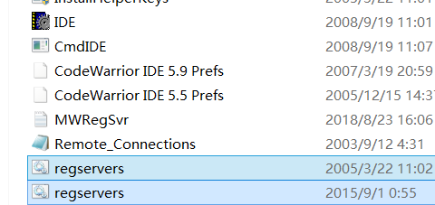

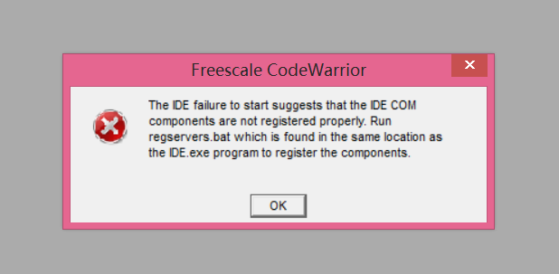

wangning92
Hey Rodney,
I follow your steps to merge all files, I think everything is fine, but when I run IED, it didn't word. When I run IDE, the error message is showed below. I also run regservers.bat, it still didn't work. Could you tell me what should I do now? Looking foward for your reply. Thank you.
41,591件の閲覧回数
wangning92
Hi Rodney,
I have fixed this problem. thanks for your post. It really helps me!
