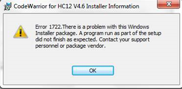

  1. A- Try to install HC12 V4.6 using default installer configuration
Launch the CW12_V4_6.exe
Next
  Next
    and
  Next + Next + Next + Next
  Select Complete and click on Next + Next and
  Install
The installation is launched.
An error message appears
  This is linked to a driver issue (P&E)
Click on OK and a second message
Click on OK
Click on OK
The installation is rolling back
And …
  The tool is not installed.

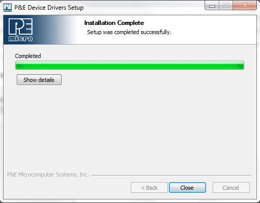

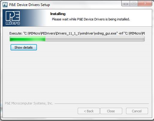

  1. C- Install new P&E drivers
Go to the P&E web site:
http://www.pemicro.com/products/product_viewDetails.cfm?product_id=33
Click on FAQs, Manuals & Downloads Tab
Under Download select: P&E Hardware Interface Drivers, Version 11 (Win XP/Vista/7/8)
PEDrivers_install.exe
Launch the installer
P&E drivers are installed.
At this point, the tool is installed.
