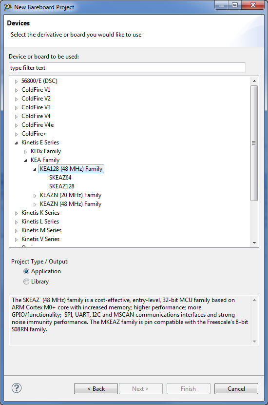

Just received the TRK KEA 128 kinetis board. I downloaded the code warrior. But while creating a new project the series EA is not found.
There is only K, L, M and N series available. Do you recommend to use the same IDE or any other IDE's for this development board.

KEA128 is supported from CodeWarrior v10.6. The attached is its release note.
The latest version is v10.6.5.
Please first install CW10.6.4 which can be downloaded from:
www.freescale.com/cwmcu10
Its update v10.6.5 is also available at the same link.
Further information and the release notes are available on the following Freescale community page:
https://community.freescale.com/docs/DOC-143655

Hi Dino,
please which version CW are you using?
You always choose what you want to install during the installation.
There is support for MCU KEA128
On my side, CW 10.6
I hope this helps.

My codewarrior version was 10.5. I will update the version.
Thanks for the reply
