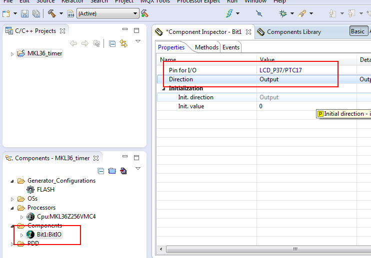

I hope that someone can walk me through on using Processor Expert to configure a line (PTC17 on the MKL36Z256VLL4).  This line would be set for a period of time (120ms to 59 seconds) and then turned off after the time period has expired.
2,642 Views
Hello Harold,
You can use component "BitIO" and "TimerInt_LDD" of PE.
- After add BitIO , configure it , select the port of PTC17, and Direction is Output:

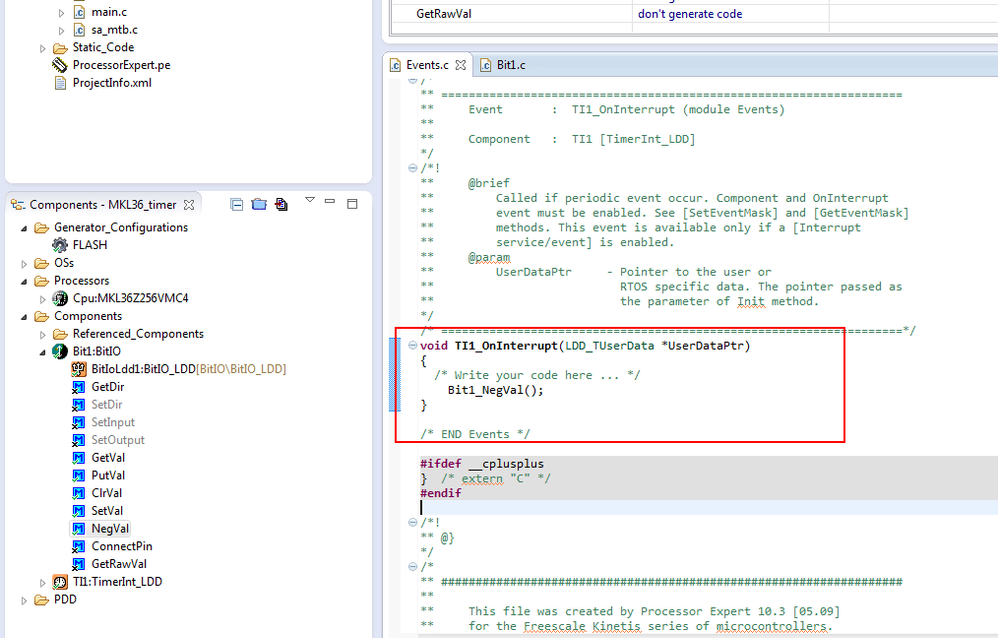

- Refer to your demand configure the timer , in the timer interrupt toggle the PTC17:
About the detail usage of these component , please refer to  help on component -> Typical Usage, there is demo code :
