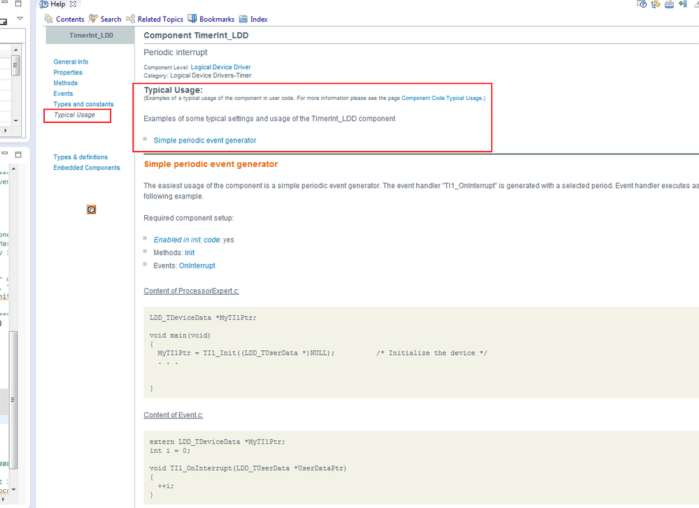

I hope that someone can walk me through on using Processor Expert to configure a line (PTC17 on the MKL36Z256VLL4).  This line would be set for a period of time (120ms to 59 seconds) and then turned off after the time period has expired.

Hello Harold,
You can use component "BitIO" and "TimerInt_LDD" of PE.
- After add BitIO , configure it , select the port of PTC17, and Direction is Output:
- Refer to your demand configure the timer , in the timer interrupt toggle the PTC17:
About the detail usage of these component , please refer to  help on component -> Typical Usage, there is demo code :
When you create , if encounter some question , you can contact me without any hesitate.
Hope it helps
Alice

Hello Alice,
What is the difference between using the BitIO and the GPIO_LDD?
H. John V.
2,492件の閲覧回数
Hello Harold,
The BitIo component implements an one-bit input/output. It uses one bit/pin of an I/O port.
The  GPIO_LDD component is a gpio driver, it can configure gpio interrupt .
IF you only want output high or low , both them are  ok.
For the detail you can refer to the "help on component " to check .
Hope it helps
