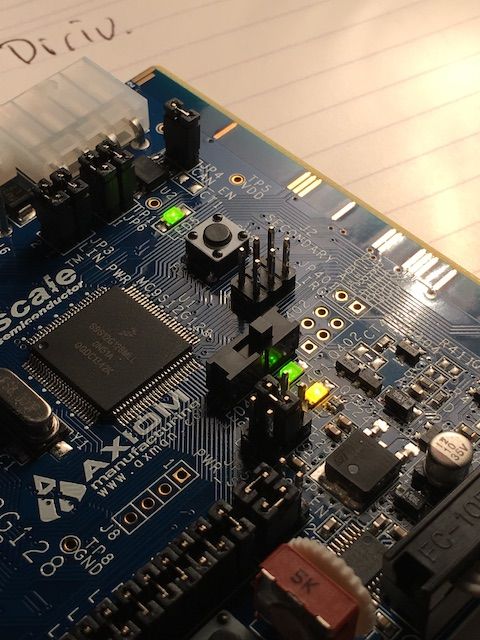

johnjferris
I was looking for answers because I had same problem.  I found obvious problem.  ON/OFF switch in off position.IMG_8303.JPG

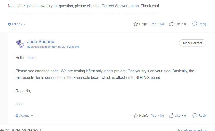

gjjude
Hello Jennie,
Please see attached code. We are testing it first only in this project. Can you try it on your side. Basically, the microcontroller is connected in the Freescale board which is attached to NI ELVIS board.
Jude

ZhangJennie
Hi Jude,
I don't see your demo code under your post. this what I see from my side
can you please post your project again?
Jennie Zhang
