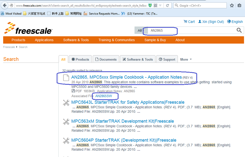

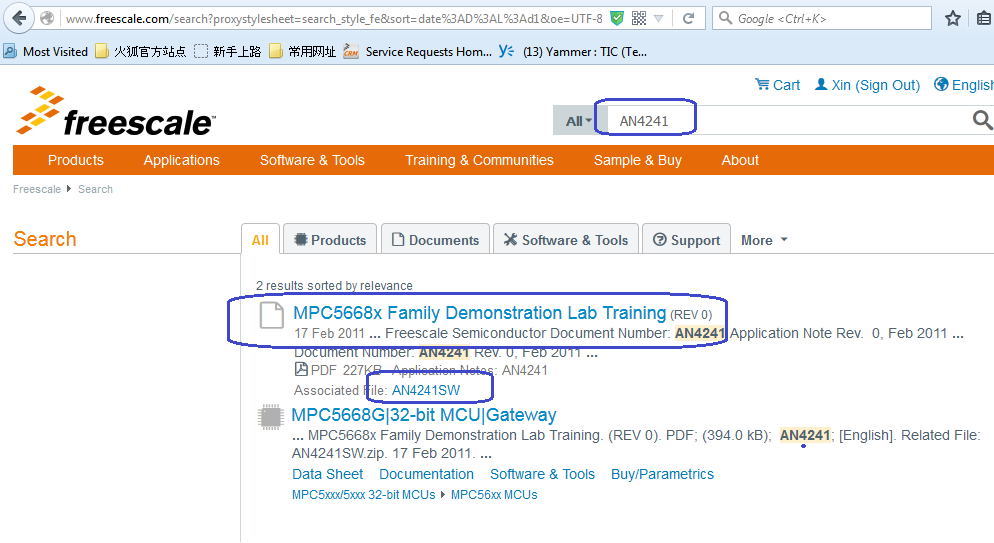

Hello All,
I have got a MPC5668G EVB. To start with the board it would to be helpful to go through some sample codes. Where can I find sample expert codes?
Ravikiran
2,457 Views
TICS_Fiona
Hello
You will find a help doc by searching AN4241 on www.freescale.com, please also download its attachment software.
The examples in AN4241 are developed with Green Hill tool.
I attached two example projects that developed by CodeWarrior.
There exists also the AN2865 MPC55xx & MPC5600 Simple Cookbook, which is not specific to MPC5668G, but many peripheral modules are similar, so it can be used as a reference. Please search AN2865 on www.freescale.com

2,457 Views
ravikiranbhairu
Hello Xin Kuang,
The attached examples are very helpful. Thank you very much. Is it ok if I contact you again incase if I get doubts?
Ravikiran
