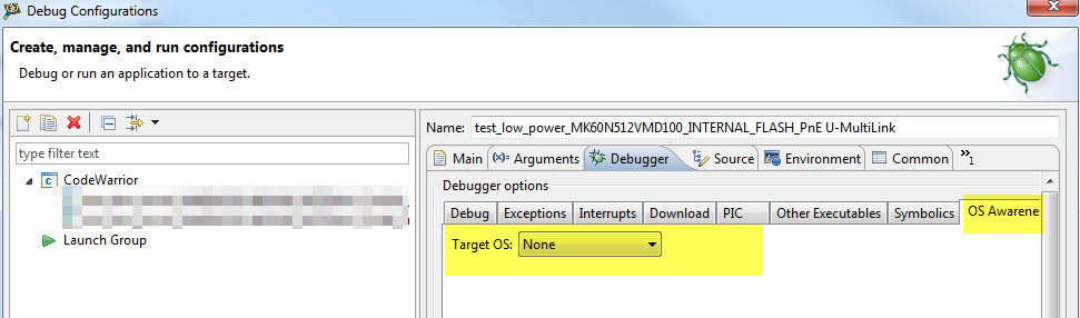

I'm trying to debug K65 with MQX application in CodeWarrior 10.7.  I have a professional license.
Every time I set a break point, it takes over 30 seconds for the windows to settle after it hits the break point.   Then, when I try to step through the code, it may take a couple of minutes to go from one statement to the next.  I'm running on 1 Windows 7 64 bit machine with 8 GBytes of RAM, so memory is not a problem.  Are there any settings I need to check?

Hi Jennie,
Thank you very much for your answers.  It looks like the .metadata folder had a problem.  After deleting the folder, the debugger became usable again.
I also tried to disable OS Awareness flag, but that did not lead to any performance improvements.

ZhangJennie
Here is some questions:
- Is this problem is for a specific project or a common issue for all project? how the debugger works if you create a new project with wizard?
- To identify if the problem is because of MQX OS Awareness. please set Target OS as "None", then see how the debug works?
- what board do you work with? FRDM or TWR board? I may suggest you update the debug port firmware and see how it works?
- backup current workspace .metadata folder then remove it from your workspace. test how debug works?
- if all above can not change anything, try reinstall CW. then test again. How does debug work?
