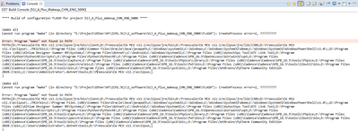

after install CodeWarrior11.1 ,I can't build my old MPC5606 project.
err:
when I open the old project(codewarrior 10.7), error occur:
when I make the project ,error occur below:
wojinandawei_1-1694765836605.pngwojinandawei_2-1694765858184.pngwojinandawei_3-1694765870332.png
I find no powerPC toolchain valid in properties page:
So, anybody who can help me deal with problem , thank u.

It seems like you haven't installed e200 (Power Architecture) package into your CodeWarrior for MCUs v 11.1 installation.
If you downloaded offline version of installer you should tick "Qorivva" component to add the support for e200.
Anyway you can always install the component via "Help -> Install New Software"
Please run the updater and install the missing component.
Hope it helps.
