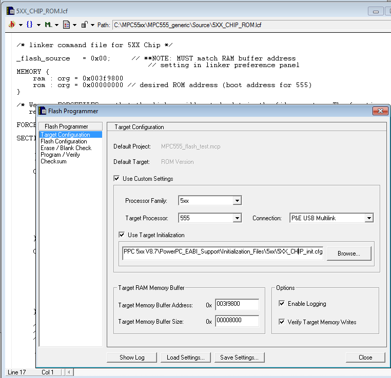

hello
i just try to erase my project and a faced by a Error of erase failed
I am not sure but I thinks it is something related to the ram problem
dose anybody know how could I should solve the problem?

I use MPC555
3,963 Views
stanish
Hi Stive,
Can you please specify which board are you using? Is it a Freescale EVB? Are you targeting internal Flash memory?
Could you possibly post your Flash Programmer Target Configuration dialog screenshot and Console Log?
Which configuration file (.cfg) do you use to initalize your board?

I'm using the board which is provide for our project
it is designed by one of our teammate
we are not using the EVB

stanish
Hi stivie,
I've successfully tested erase and blank check of the internal flash of MPC566EVB.
see my target configuration screenshot:
It uses internal SRAM buffer. so it should work without the External SRAM on your board.
At which address the blank check fails? perhaps the number Flash programing cycles (at 0x8000) has been reached, so you are unable to reprogram it..
Can you possibly try to create an empty bareboard project for MPC555 build it and try to flash it?
Hope it helps.
Stan

stive
Hi there and thanks for your reply
I use CW8.7 and
The error occur when I tried to do programming by using flash programming
In this case I have some problems
1st in the case of blank check I faced by error:
Fail reading mismatch address
And then connection failed
2nd in the case of program and verify when we do verify it said:
Data Mismatch at address: 0x00008000 Expected: 0x48 Actual: 0x00
i guess it is maybe is related to the ram addressing or something which is related to
thanks for your help
