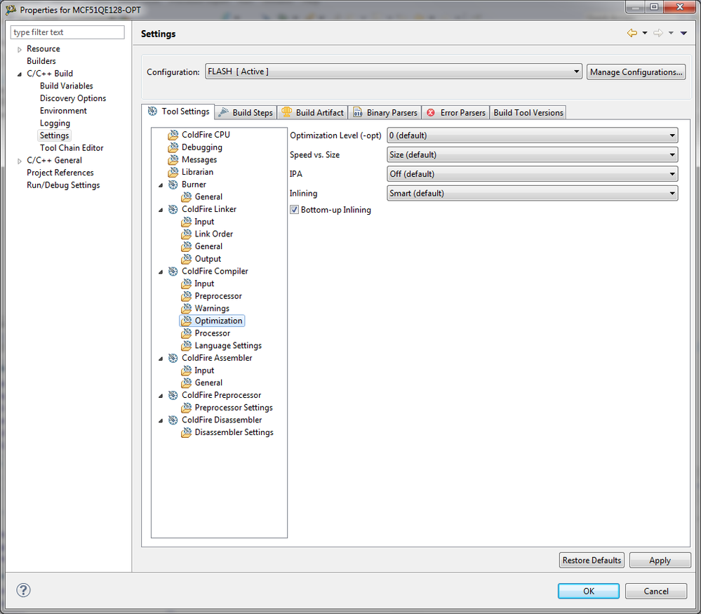

Hi Eugenio Mendez,
The program might be running slower on CodeWarrior 10.6 because of the Optimization Options in the compiler, you can modify these options by going to Project>>Properties>>C/C++ Build>>Settings>>ColdFire Compiler>>Optimization:
The option "Speed vs Size" allows you to optimize the code for a faster execution speed, you can find more information on the chapter 3.3.2.5 in the CodeWarrior Development Studio for Microcontrollers V10.x ColdFire Build Tools Reference Manual located at C:\Freescale\CW MCU v10.6\MCU\Help\PDF\MCU_ColdFire_Compiler.pdf.
Regards!
