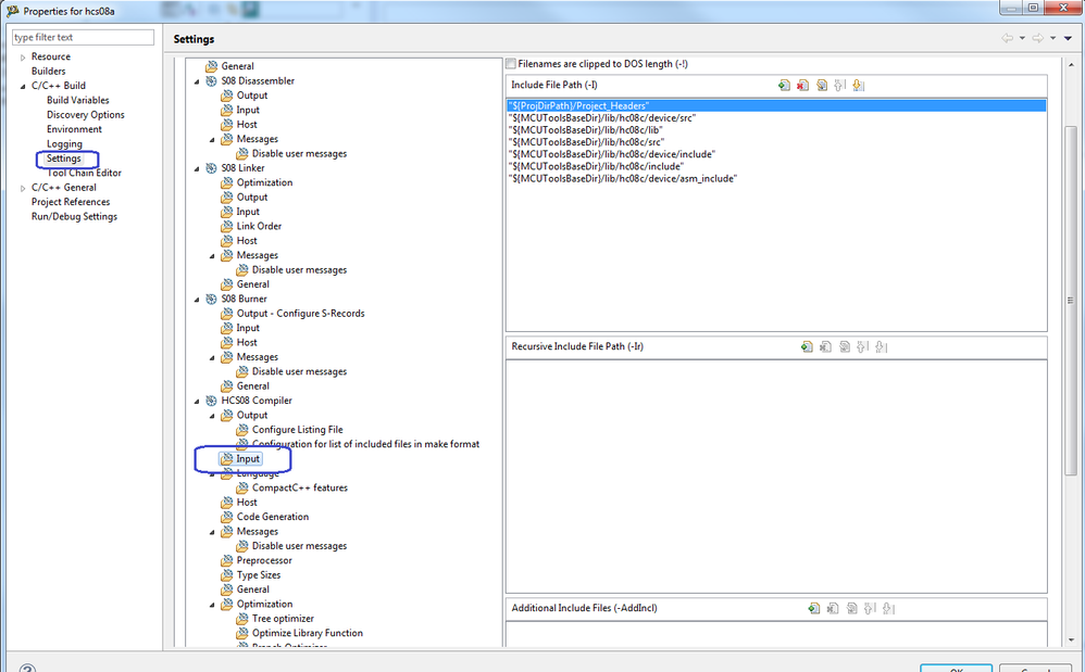

In Eclipse CodeWarrior,  user can also set the search path for head files and libraries. For head files, please set its search path from <Project> Menu->Properties, then go to “C/C++ Build”-> Settings -> HSC08 Compiler-> Input.

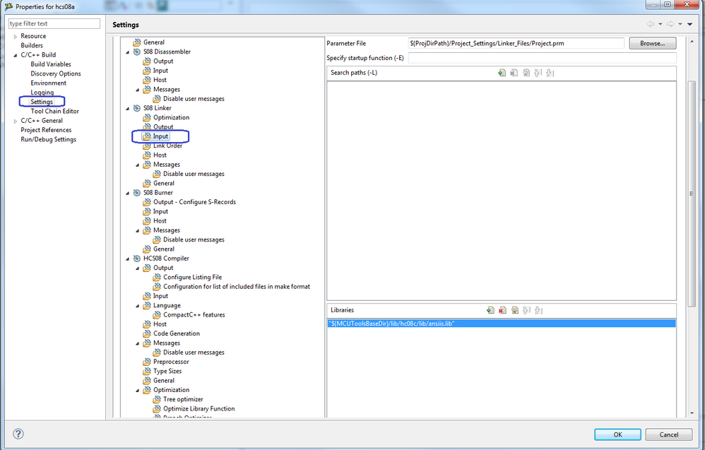

For libs, please go to “C/C++ Build”-> Settings -> S08 Linker-> Input.

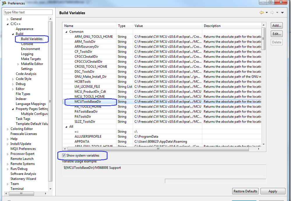

User can find the definition for Build Variables from <Windows> Menu-> Preferences, and checked “Show system variables” option.

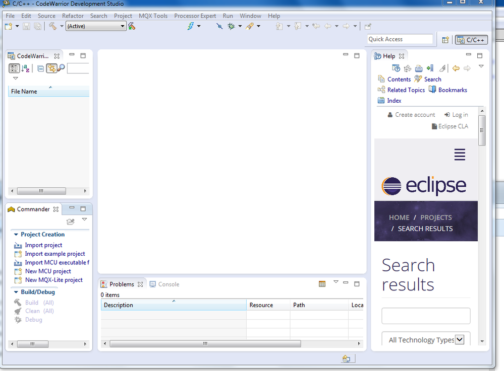

Here's what Eclipse CW presents to me -
Please provide details on how to proceed from this point.

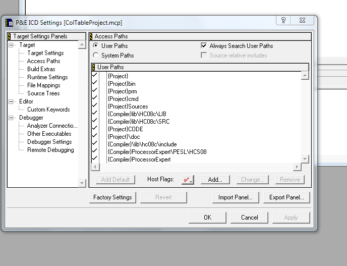

jes
Here's a screen shot of the {Project} and {Compiler} references for the Access Paths.  The current {Compiler} setting for this project, previously run on Windows XP with a different folder structure, is relative to that installation for that version of CW.  How do I change it?
