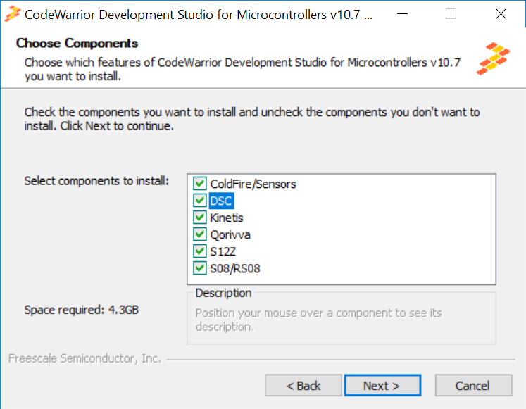

I encountered an error while installing Code Warrior to build wct1013a.
I get an error when I download the service pack and install the zip file.
  Missing requirement: MCU v10.7 DSC Service Pack for Wireless Charging MWCT101x 1.0.1 (com.freescale.mcu10_7.Wireless_Charging_MWCT101x.win.sp.feature.group 1.0.1) requires 'com.freescale.mcu10_7.product [1.0.0,20.0.0.RT5]' but it could not be found.
what should i do?
4,026 Views
ZhangJennie
Hi Semi,
Here is the point you need pay attention:
- during install CW10.7, please sure DSC component is selected
- open on line update page, make sure DSP support and MCU v10.7 DSC Service Packs are updated, if not, please update them.
