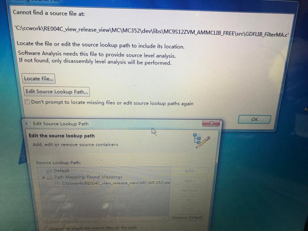

When I import a new project and debug, it comes as the picture below:
I can't find the source in my computer. What is the function of it? What can I do to replace the path? Where can I find MC912SZVM_AMMCLIB_FREE\src\GDFLIB_FilterMA.c?

I use the demo AN5135. I have change it to S12ZVML31.  You can download it at Search Results: AN5135 ,the first result.
You can find the find the source path in Debug Configurations-->Source. I can,t find the path"C:\ccwork\RE004C.......". I can't find MC912SZVM_AMMCLIB_FREE ,also.
I think if I can find MC912SZVM_AMMCLIB_FREE library and change the path ,the question will solve.

I found below path was added in Source tab, which we don't need, please remove it. Please see my testing video attached.
Jennie Zhang
6,447件の閲覧回数
frankkong
Hi ,Zhang Jennie
  I have remove the Source tab in my project. It doesn't work.

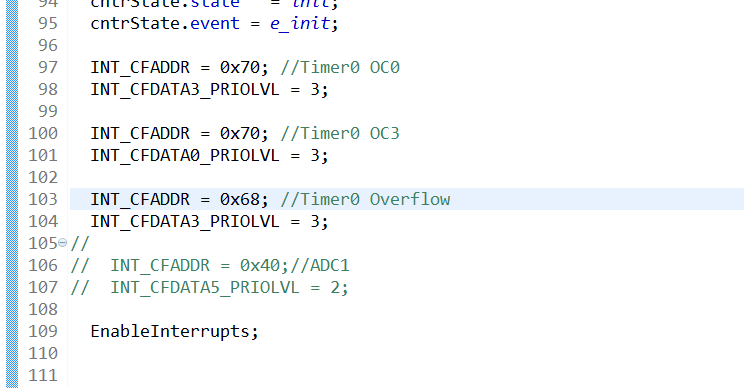

I use the interrupt of Timer0 IOC0 and IOC3. IOC3 is for input capture and IOC0 for output compare. The timer base frequency is 200K.  The problem is when I set the different priority it will meet some problem. If I set the same priority it works well. You can see the problem below:

Thanks for your attention. I have test it on another computer. Now I disable the "Trace and Profile" at the "Debug Configurations" and delete the invalid source path. The problem has been solved.
Thank you very much.

    I have change my computer. Can you see the Source Lookup Path--Path Mapping:Found Mappings? As show in the picture. Can you find "C:\ccwork\RE004C_view_release_view\MC\MC352....."  in the project or your computer? I will test it on another computer.
Thanks.
6,447件の閲覧回数
frankkong
Hi,ZhangJennie
   I use CW11.0. It work as well if I ignore the hint. As the picture below , I delete the source path. It doesn't cause any mistake. I just want to know the meaning of the Source Lookup Path?pastedImage_1.png
