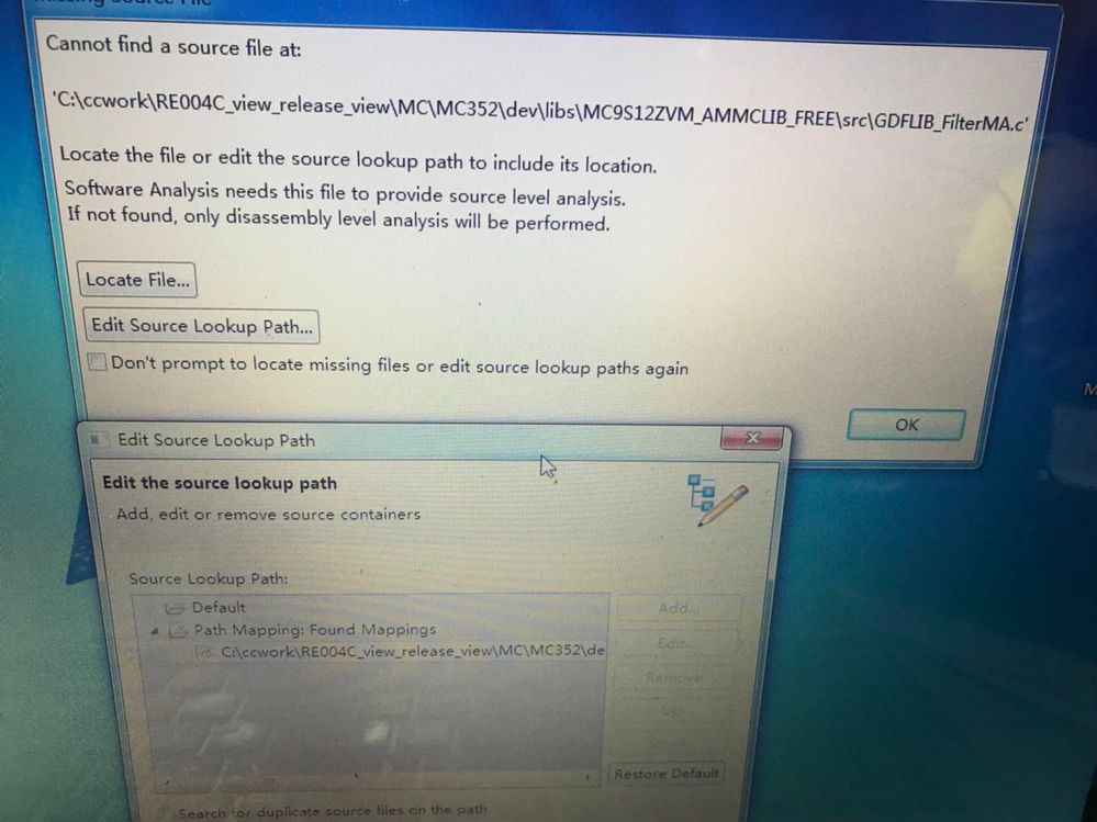

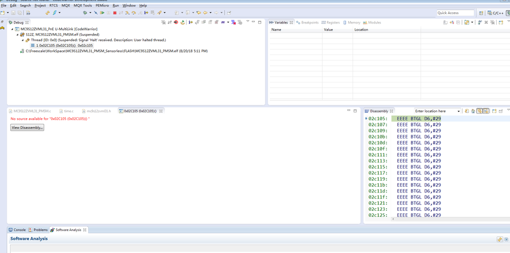

When I import a new project and debug, it comes as the picture below:
I can't find the source in my computer. What is the function of it? What can I do to replace the path? Where can I find MC912SZVM_AMMCLIB_FREE\src\GDFLIB_FilterMA.c?
Thanks!

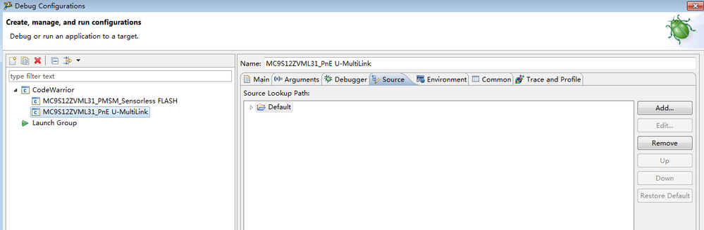

I use the demo AN5135. I have change it to S12ZVML31.  You can download it at Search Results: AN5135 ,the first result.
You can find the find the source path in Debug Configurations-->Source. I can,t find the path"C:\ccwork\RE004C.......". I can't find MC912SZVM_AMMCLIB_FREE ,also.

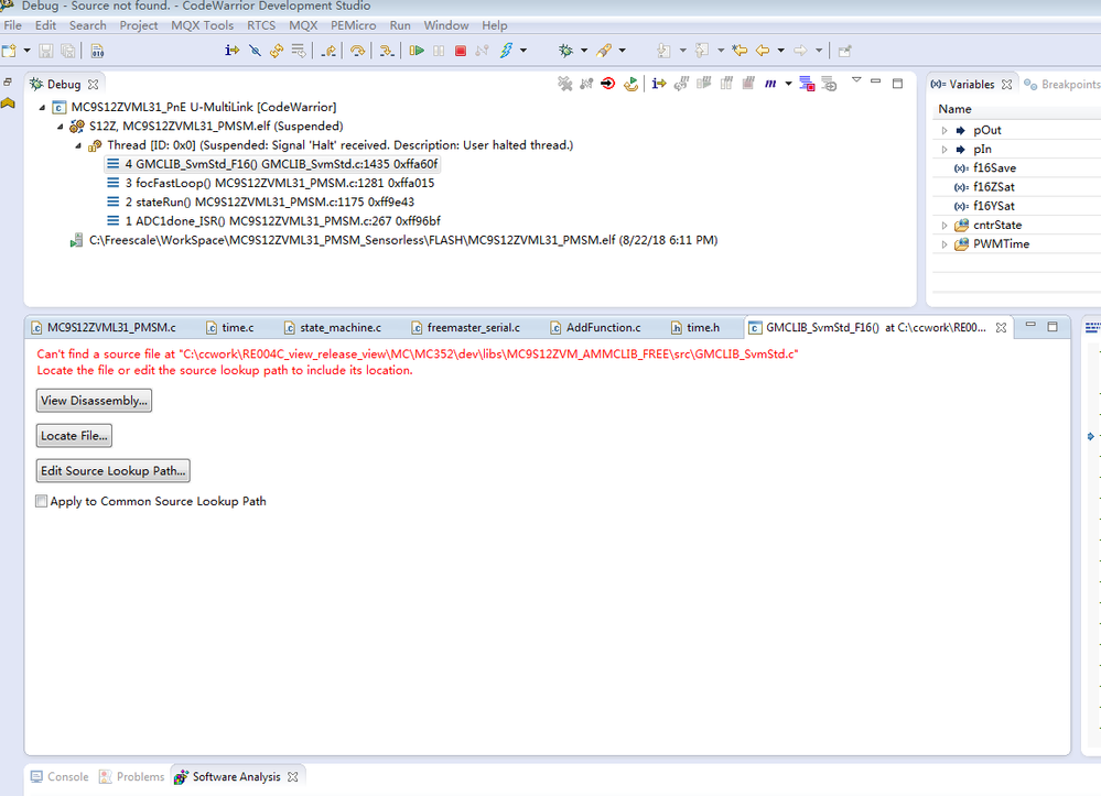

frankkong
Hi, ZhangJennie,
    If I press suspend or add breakpoint while running ,It will display the error.The source path is the same.

ZhangJennie
Hi Frank,
I found below path was added in Source tab, which we don't need, please remove it. Please see my testing video attached.

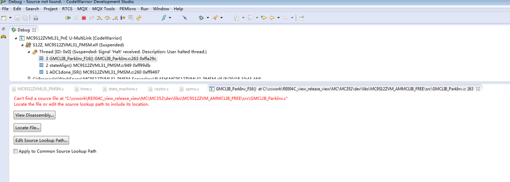

frankkong
Hi, ZhangJennie,
   It doesn't work. I use CW v11 too.
    You can add a breakpiont at StateRun() while running under debug.Then you can see the problem.
Now I disable the Trace and Profile,it will not cause the problem in most cases.

frankkong
Hi, ZhangJennie,
Thanks for your attention. I have test it on another computer. Now I disable the "Trace and Profile" at the "Debug Configurations" and delete the invalid source path. The problem has been solved.

    I have change my computer. Can you see the Source Lookup Path--Path Mapping:Found Mappings? As show in the picture. Can you find "C:\ccwork\RE004C_view_release_view\MC\MC352....."  in the project or your computer? I will test it on another computer.
Thanks.
6,681 Views
frankkong
Hi,ZhangJennie
   I use CW11.0. It work as well if I ignore the hint. As the picture below , I delete the source path. It doesn't cause any mistake. I just want to know the meaning of the Source Lookup Path?pastedImage_1.png
