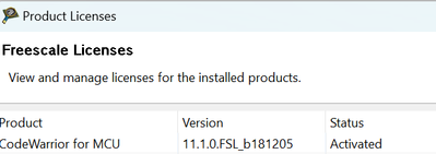

CW11.1 license error
1,997件の閲覧回数
leolv
Installed Products:
 - CodeWarrior for MCU
Version: 11.1
Build Id:181224
#above is version and license information
#but when i open the IDE it always report errors below
how to fix this issue
In addition i am not sure where i should place my licesne.dat in client side.

Hello @leolv ,
Thanks for your post. From your picture, it shows that your license.dat is in the right place and has been activated successfully. There's no problem. Regarding the log "CDE: no license found, using Community Edition License", it is not an error log but a normal one, and the appearance of this message will not affect the normal use of CodeWarrior. CDE means the Component Development Environment. You can refer to the link below for more details.
Solved: What tool do I kneed for Component Development? - NXP Community
In short, this log is not an error and won't affect your use.
Hope it can help you.
BRs,
Celeste
