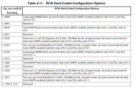

Dear YipingWang,
Sorry!  How to use hard-coaded RCW?
Thank you!

6,124 Views
yipingwang
The device can be initialized with a hard-coded RCW option, selected by the
cfg_rcw_src[0:4] configuration inputs.
The following table describes hard-coded RCW configuration options.
For details, please refer to P2040 Reference Manual.
6,168 Views
yipingwang
Please refer to page 6 in attached PPT about JTAG hardware design.
Please ensure HRESET not tied to TRST, HRESET to the processor exclusive to COP/JTAG header.
Please use hard-coded RCW.
