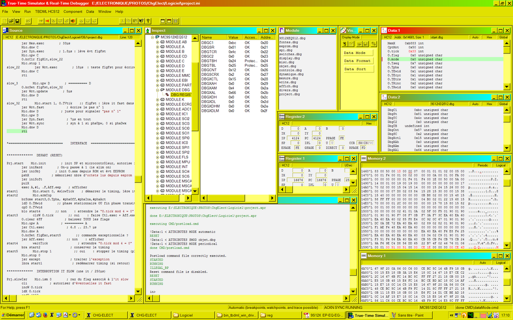

Almost everything works fine, but watchpoints (in particular breakpoints work well).
I can set watchpoints and they appear in data and memory windows of Hiwave.
But the program doesn't stop when the corrresponding memory location is read or written.
I did some investigations, and it seems that comparator adress registers of the DBG module are not written correctly by Hiwave when I set a watchpoint.
Examples:
watchpoint set at address $1450  --> DBGXAH:M:L = $00:04:50              (04 instead of 14)
                                                $2450                                   $00:E4:50               (E4 instead of 24)
                                                $3450                                   $0F:F4:50
DBGXAL is correct, but DBGXAM and sometimes DBGXAH are not.
If I try to manually modify these registers (in data or memory window, or with the Inspector)
they are immediately rewritten with the erroneous values !
The RAM of my application extends from $1000 to $3FFF, and the RPAGE register has its reset value : $FD.
The debugging memory map has a range covering from $1000 to $3FFF (physical) with R/W access.

Here is a screen print showing my problem.
A watchpoint is set on the variable O.mode (address $0x1466) : see Data:1 and Memory:2 windows.
No other watchpoints or breakpoints are set.
You can see in the Inspector window (or in Data:2) that DBGXAH = 0x0, DBGXAM = 0x4 (instead of 0x14), while DBGXAL is correct (0x66).
This is typical : DBGXAM is always incorrect, DBGXAH sometimes incorrect.
I had no opportunity to try another physical target than TBDML. However watchpoints work perfectly well with the simulator.
So I suppose the issue is somewhere in the dll (or gdi dll) used to communicate with the TBDML target.
