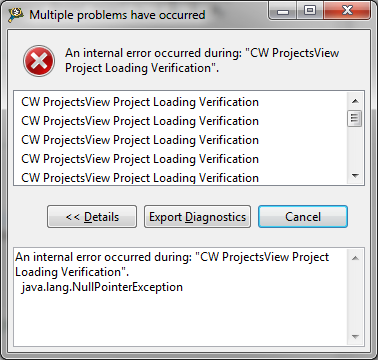

I fired up CW 10.5 this morning and this popped up.
It worked fine yesterday and I haven't installed any plugins since then so it's a mystery to me why CW is in this unusable state.
I uninstalled and reinstalled but the problem persists which leads me to think that something is wrong with my workspace.
I did start using the Team Foundation Server plugin yesterday so maybe that messed something up but the problem persists without the plugin loaded.
I think making a new workspace will fix the issue but I'd rather not have to keep doing that.
Anyway, if anyone's run into this problem before I'd love to know what caused it.

could you give it a try and load Eclipse with a new workspace to see if the problem goes away?
From the naming in the error it looks like the project view has a problem verifying the project.
The details of the error are in the .metadata\.log text file inside your workspace. Maybe you could post it (or at least the stack trace with the problem).
If a new workspace solves your problem, then should be able to easily migrate your projects to it (you can drag&drop multiple projects into a new workspace).

This error message is repeated several times in my .log file.

I found this https://community.freescale.com/message/352771#352771 just a few minutes ago and it fixed the problem.
You simply delete parallelBuildOn="true" from the .cproject file and the error goes away.
It saved me from having to rebuild my workspace at least.
