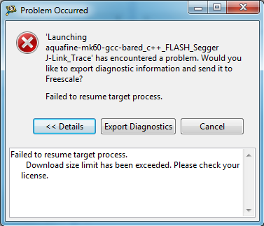

I create a new bared project, which using gcc and c++.
I build the project sucessful, then debug but failed as show below.
It' a empty project so i think it will not exceeded the size limit, but why failed?

Hello matherine wang:
Is this the Special edition CodeWarrior for MCUs?
If so, then it does not support C++ code, only C. The next article will explain you this error window:
Please Check Your License | MCU on Eclipse
