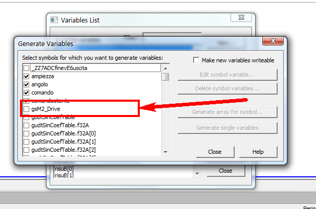

The CW10.6 in debug session do not show the structure of the variable:

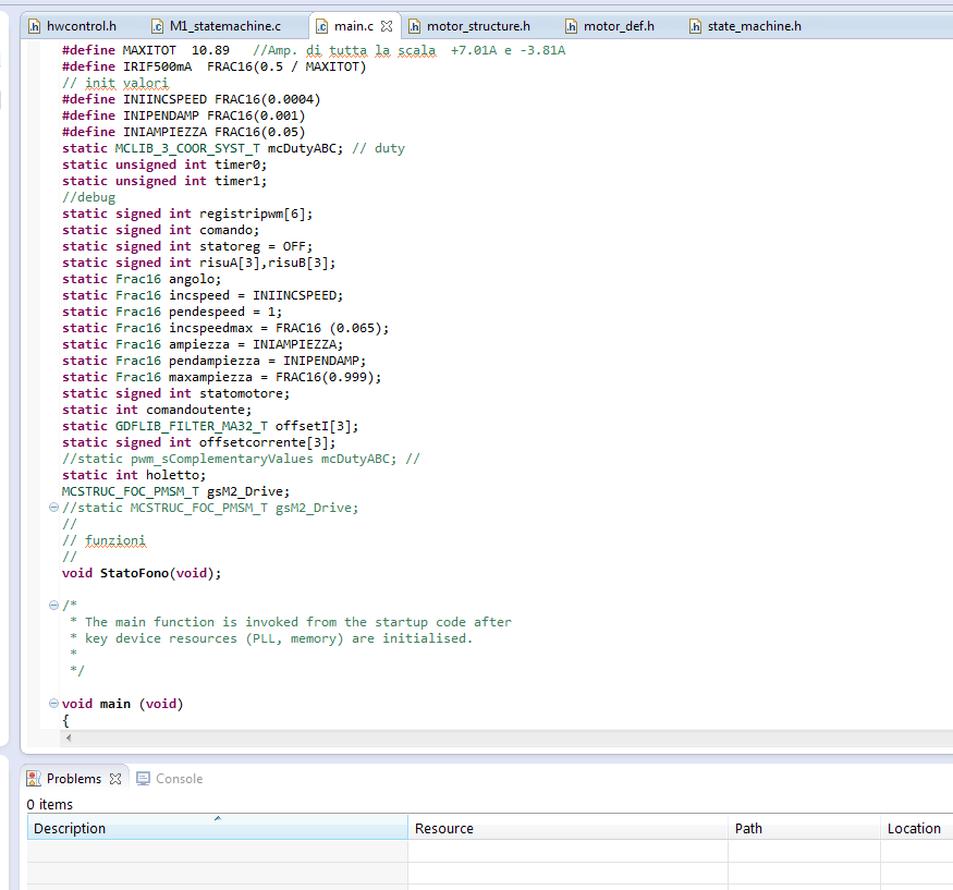

the variable is declared in main.c like:
"MCSTRUC_FOC_PMSM_T gsM2_Drive;"
the structure "MCSTRUC_FOC_PMSM_T" is composed like:

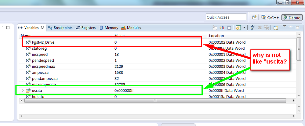

BUT the degub program do not show the variale of the structured "gsM2_Drive" like i showed in the following picture:
The same problem happen with this project in Freemaster.
Freemaster do not show me the structure of "gsM2_Drive" !
Somebody can help me ?

antonio66
Hi Eric,
You are very reactive ! thankyuo a lot.
Yes before the declaration is included
#include "motor_structure.h"
where the type of structure is declared.
If is an include problem why the compiler work right ?
why the execution of the firmware is right and the other variable in freemaster work well ?

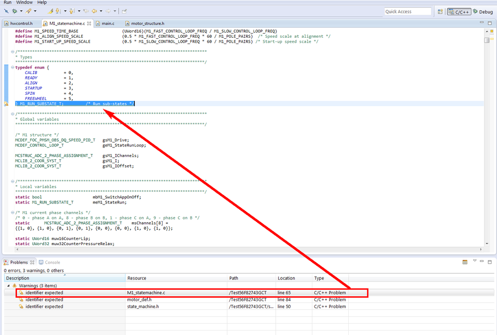

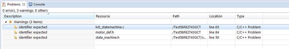

antonio66
Hi Erich,
The first warning is...
6,102 Views
BlackNight
remove the comma after the number 5.
6,102 Views
antonio66
Hi Erich,
..done. Now i have no warning.
But still the problem is alive.

BlackNight
Hi Antonio,
I suggest that you fix all the warnings anyway.
That you can compile your sources does not mean that the debug information is correct (DWARF). The debugger and Freemaster rely on the debug information to show the variables with types. Are the other variables from that module shown properly? Not that you just have switched off debug information for it.
Erich

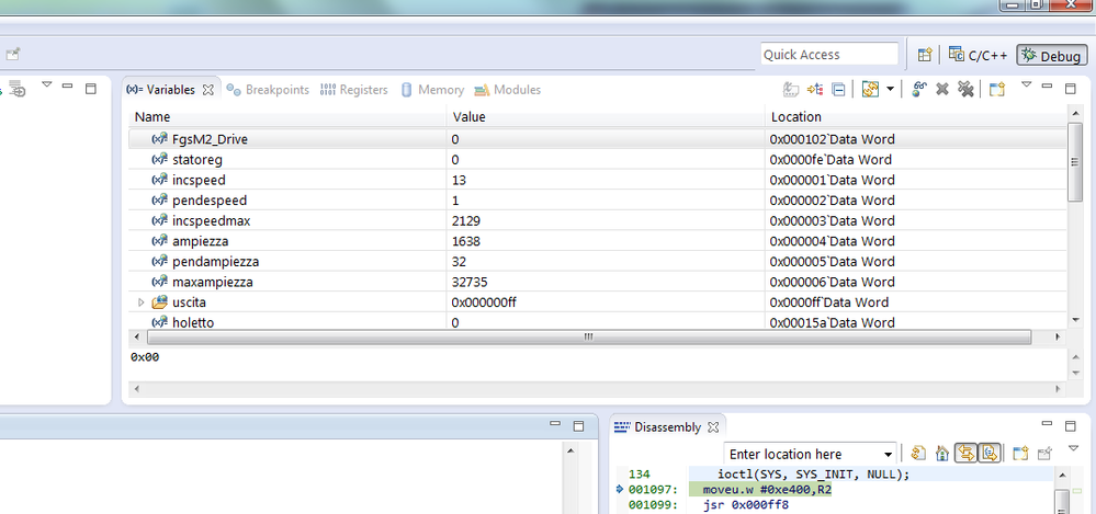

antonio66
I show you some of the others variables of the module..
..and the others variables are visible in debug like you can see here..
.. i also tried to "add global variable" in the debug session and than i tried to "Cast To Type" in debug variable window without success.
