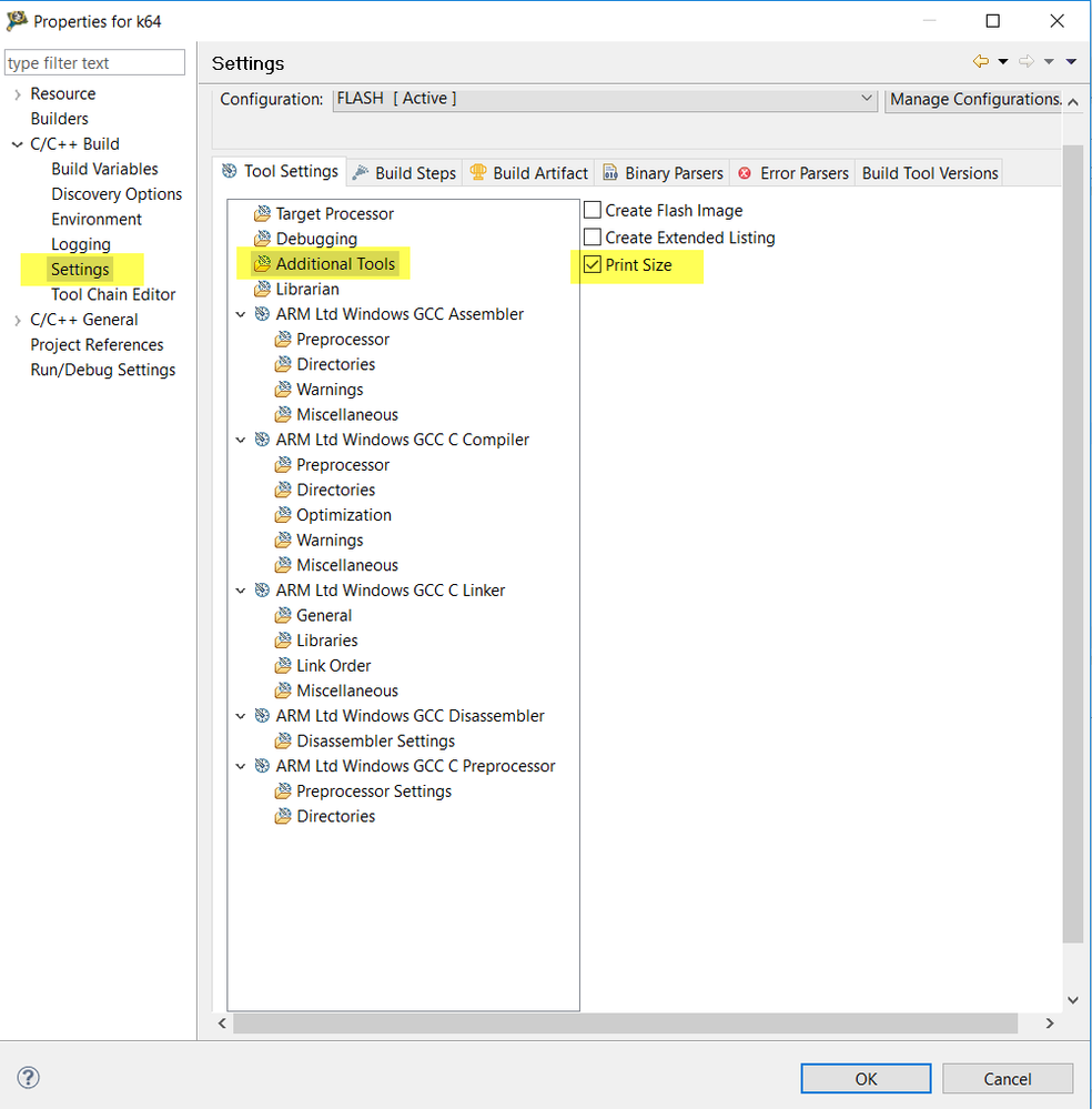

I am new user of Code Warrior and i would like to know where can i see the expected memory resources from the CPU after compilation?
I used to see this information in the console window right after compilation completed.

Hello Dudi Varshavski ,
Please tell me the version of your CW and chip, for example the CW10.x, after enable "Print Size", you will
see the size on Console view:
Hope it helps,
TIC
