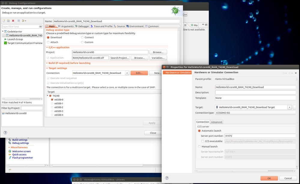

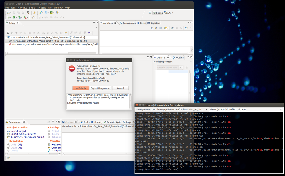

richardprokesch
Thanks for the fast reply!
I tried CodeWarrior on latest Fedora 64bit and Ubuntu 64bit version and got the same error messages.
Here is a screenshot of my debug configuration:
And here is a screen shot of the error message (in the terminal window you can see that ccssim2 is automatically started by CodeWarrior).
Did I forget something to configure?
Richard

marius_grigoras
According with the
Installation(make sure you run on a linux 64-bit machine): PA\ccs\bin\linux64\sc3900_swsim_README.txt
1. Unzip the package in some folder with keeping archive directory tree.
2. cd to the archive directory.
3. run ccssim2 server for connection with CW or runsim for batch mode simulation(make sure to change all files permissions to executables)
  Example: ./ccssim2 -port 40969
4. If you run with CW you need to make the following changes to the project after ccssim2 is started on linux 64-bit machine:
  - go to Run - Debug Configuration - select the configuration for your project
  - go to Connection - Edit - Connection - check Manual launch
  - put at Server hostname/IP - the ip of the linux 64-bit machine where you started ccssim2 on
  - put at Server port name - the port on which you started ccssim2(in our example 40969)
So, please make sure the simulator is running and the debugging port is correctly set up in CW.
Marius

richardprokesch
Thanks, that helped!
I didn't noticed the linux64 directory in PA\ccs\bin path.
After decompressing the tar file and starting up ccssim2 manually from the linux64 path it worked.
Richard
