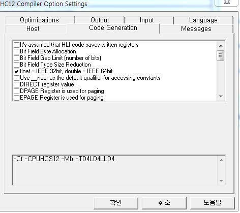

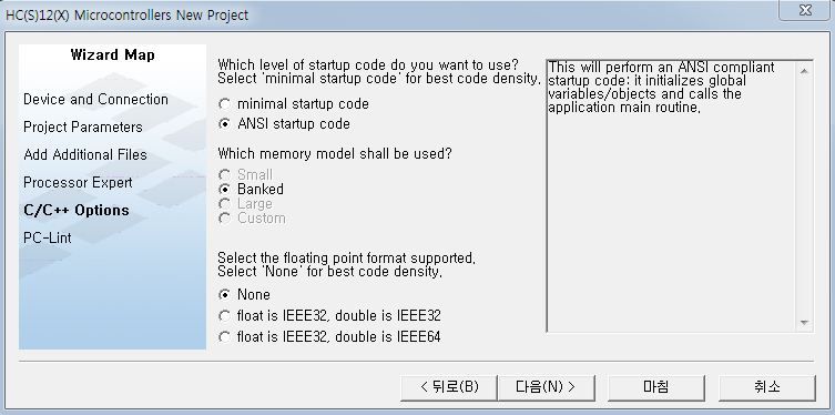

- When I created my current project, I configured it not to use 'floating point operation'. (refer pic.1)

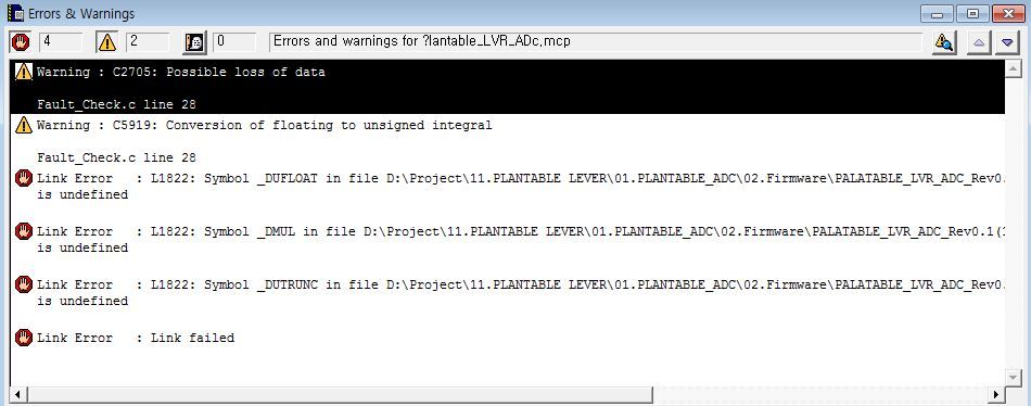

- But now, I need some floating point operation for my project so I applied it. And then some errors happened on my project when I compiled it. (refer pic.2)
- Of course, I set the 'code generation' as below.
I want to know the solution.
And I need to solve this error on my current project except making new project because I almost completed this project.
Please answer me if there are any solutions.

And I already removed the ‘_NO_FLOAT’ and used the ‘ansi.lib’.

Following the Erich feedback I've created an example using the simulator under HC12 v5.1 for 9s12DP512.
I've created the example for banked memory without floating.
The default example is defined in the Standard target.
Then I've duplicated the target and follow the process described in the link:
      http://mcuoneclipse.com/2013/05/08/addingremoving-floating-point-format-for-s08-projects/
I've changed the ansibi.lib by the ansib.lib.
Now the example is working fine.

I could not change ‘xx.lib’ file but I could only select some option at the H12 Compiler Option Setting as the attached file.

Hi Kim,
the lib must be changed manually.
Attached you will find a video showing you how to convert a non_floating project to floating one.
Pascal
