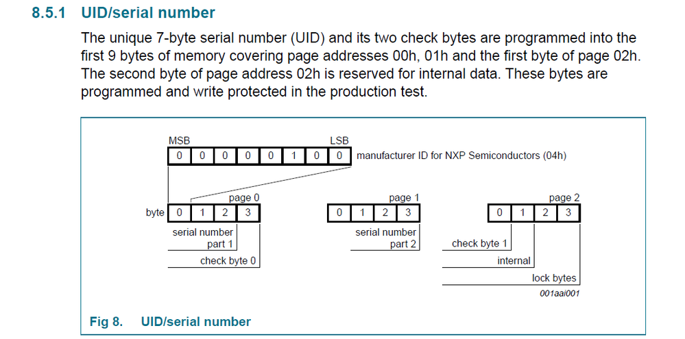

Speaking about unique IDs, I've been told that each card has an ID, and that the pages that store the IDs can never be overwritten right? So is it safe to assume that if I bought one million NTAG213 cards, I'd never have to worry about a duplicate ID? If that is the case, is it possible for me to instead just write a program that reads the ID from each card and use that instead of writing an ID to each card? How can I get a program I'm writing to read that ID?

Hello N'Kenge Drew, Hope you are doing great, for the ACR122U please confirm which part of NXP is using or please try to contact their support.
for the NTAG213   please check the  next document NFC Forum Type 2 Tag compliant IC with 144/504/888 bytes

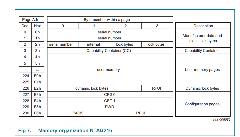

user memory in the the UID is allocated in the 00h and 01h
and it is allocated in 7 bytes  like this
to read this you will have to send a READ command  and in the address  you will have to put the 00h and the 01h in order to get the full UID you will have to read two times.
for this command in the document you will find the NTAG commands in the section 10. please check this information and tell me if this  helped you.
