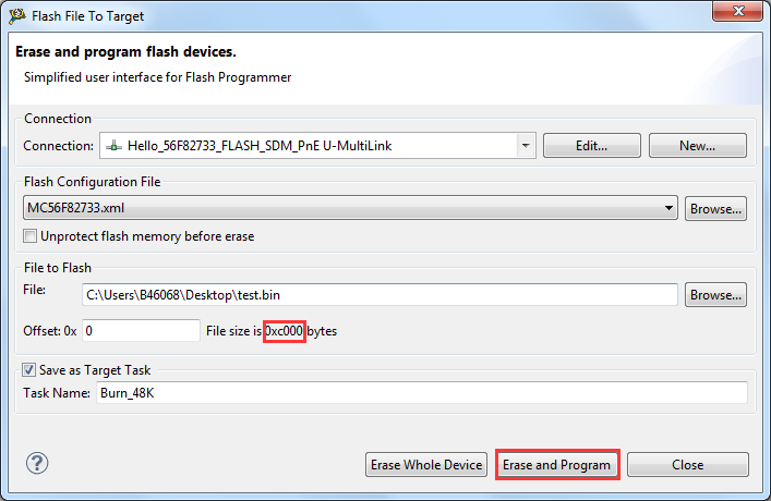

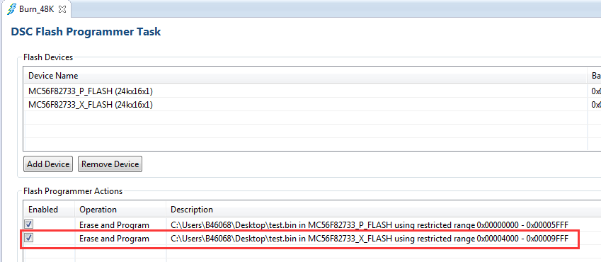

I use the Flash programmer to burn a 48KByte bin file to MC56F82733, but I find the MC56F82733's first 8KByte flash have been erased, and the rest is OK.
I also find if no use the second Erase and Program X_FLASH task, all the data can program to the chip. I don't know why the second script can erase the first 8KByte data, and not program the data.

ZhangJennie
Hi Tony.
I don't have exact your chip but I reproduce the similar issue on 56F82748.
This problem was escalated to development team DTDBGPG-849.
I will let you know as soon as I get any feedback there.
