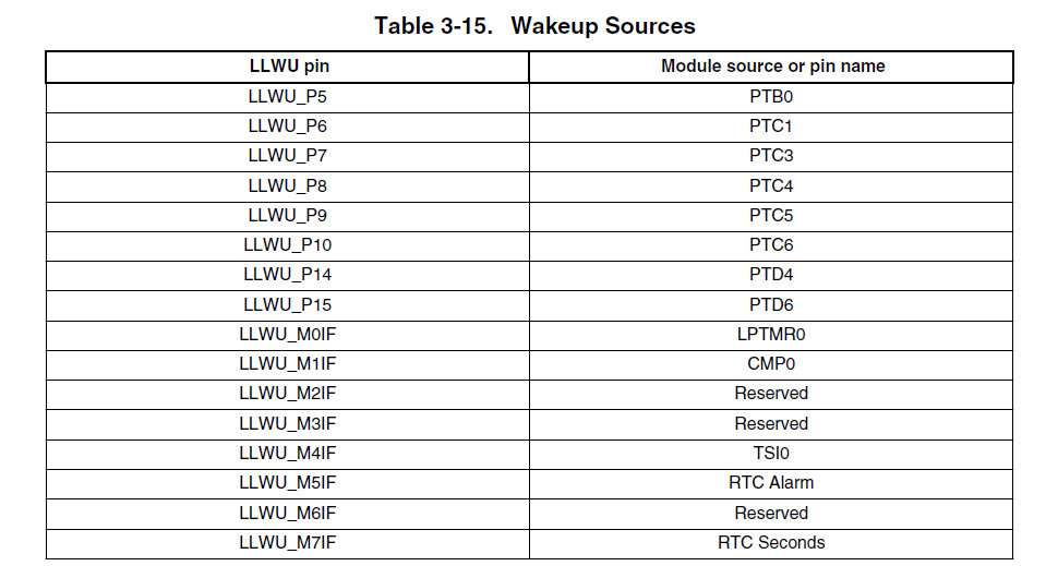

Hello Harold,
(1) The kineits L series produces support the maximum volt is 3.3V,
    so we can not use the 12v volt , must under 3.3 v.
  About the wakeup sources , you can check it at the reference manual :

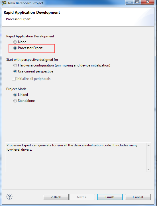

(2) About use the Processor Expert on CW, when you create project , please select it
Then about add one button , you can use the GPIO interrupt . So you can add the component
of "GPIO_LDD" component , then configure it refer to your requirement , about the usage example
of this component ,you can refer to the "Typical Usage":
