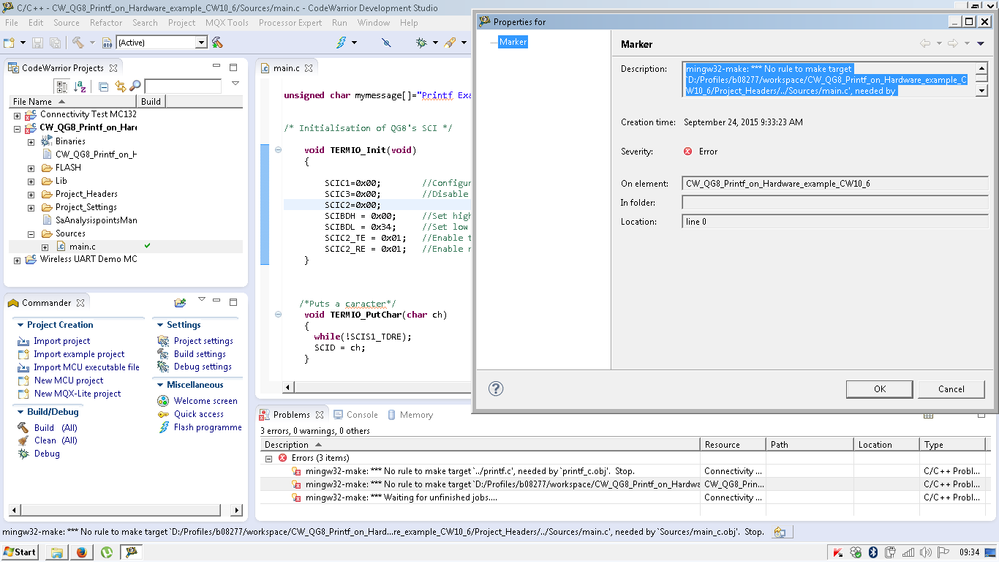

My card has been designed in house designed by the university and I can not connect with Hyperterminal.
I'm trying to print to console me but CodeWarrior error.
To recognize the command printf I added #include <stdio.h>.
I added in the same folder: printf_c.obj, printf.he printf.c.
Then in the main after I wrote simply: printf ("AAAA \ n");
But I 2 errors:
-mingw32-make: *** No rule to make target `../printf.c ', needed by` printf_c.obj'. Stop.
-mingw32-make: *** Waiting for unfinished jobs ....
How can I print in the console?

there is no way to print string to console window for HCS08. it's possible to do it for kinetis but not for 8bit mcu.
regarding to my demo code, please perform clean first then build again.
see attached video.
can this help?

MC13233 is HCS08 core. CW10.6 doesn't support to print to console window.
user have to print string to SCI terminal instead.
I ever made demo for 9s08qg8. see attached. both MC13233  and QG8 use HCS08 core, so the method is same. it;s simple and readable, Hope it helps.
can this answer help you?

nikivendola
With the response, with the truo program gives me the same mistakes, I have attached a schreen shot.
There's no way to use it from the console of CodeWarrior?
If I can not print to the console CodeWarrior is useless to continue?
