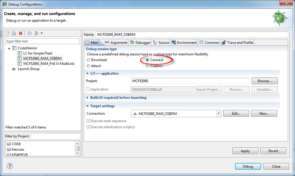

If you are not familiar with CodeWarrior 7.2 you can also use CodeWarrior 10.6 and take a look to the below posts created by our colleague Erich Styger:
https://mcuoneclipse.com/2012/10/10/attach-connect-download/
https://mcuoneclipse.com/2012/05/04/dump-my-device-memory/
The first one explains how to connect to a running target without programming it using the "Connect" option in CodeWarrior:
The second one shows how to dump the memory of the device using the "Memory view" once you have connected to the device.

Thanks Carlos! Unfortunately the BDM interfacing device I have isn't compatible with the Eclipse-based versions of CodeWarrior (and I'm having trouble getting it to function with 7.2 for that matter), but the information you've provided is still valuable. It looks like debugging even in assembly probably won't be possible without the source, but I should at least be able to dump memory and maybe disassemble the thing, assuming I can get the BDM device to work.
