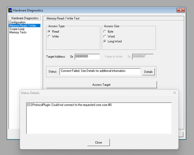

Dear [Support/Team],
I am using the MPC8358E chip for my project. The software code for this project was originally developed in early 2016 on a Windows XP PC (let’s call it the reference PC). I was not the original developer.
Now, I need to make some modifications to the code for my new design. I have moved to a Windows 11 (64-bit, 8 GB RAM) PC (let’s call it the new PC).
I downloaded and installed CodeWarrior™ Development Studio for Power Architecture™ Processors V8.8 from the NXP website. Using this tool, I can run hardware diagnostics to check the hardware connection. However, when I connect using my new PC, I am getting an error indicating that the hardware is not connected.
Below i am share the screenshot  for your reference Screenshot (40).pngScreenshot (40).png
When I connect the same hardware setup to the reference PC, it connects successfully. This confirms that both the hardware and the JTAG interface are working correctly.
I have copied and verified the IDE preferences and target settings (for both Debug and ROM versions) from the reference PC to the new PC. Everything seems correct, but I still face this connection problem.
Please help me resolve this issue, as I need to complete the project by the end of this month.

nitheeshkumar
hello,
NXP Tec support,
The link is not opening. If you meant that link have 8.8.6 Patch file, I’ve already installed everything as suggested, but I’m still experiencing the same issue.
