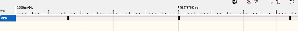

Dear all,
I have a S08PT60 and at the start of code, I disable the watchdog timer, but, after 6,2 ms the cpu reset.
I think that there is a error in my startup code . . . . but i don't find it !!
This is the my simple code:

I have uset the PC5 for verify if the cpu reset, and it is reset every 6,2 ms
Please help me !!

IlConte
Solved !!
The problem it isn't the value, but the dimension of WDOG_TOVAL, for takes effect it is necessary to write all register, and I wrote only the low of  WDOG_TOVAL
Thanks for making me understand the differences and bringing me on the right track.
