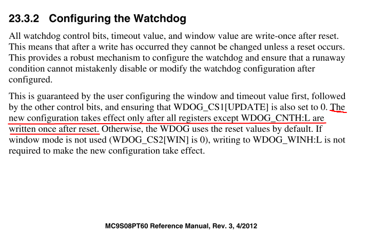

Dear all,
I have a S08PT60 and at the start of code, I disable the watchdog timer, but, after 6,2 ms the cpu reset.
I think that there is a error in my startup code . . . . but i don't find it !!
This is the my simple code:

Having now looked at the PT60 reference manual I'd agree with you that the code is correct and within the stipulated timings. Of course one hopes that the code in the reference manual is correct in itself ;-) The only difference I can see between your code and Freescales is the following line:
WDOG_TOVAL = 1000; // setting timeout value
You're setting 4 hex and they 1000 decimal?

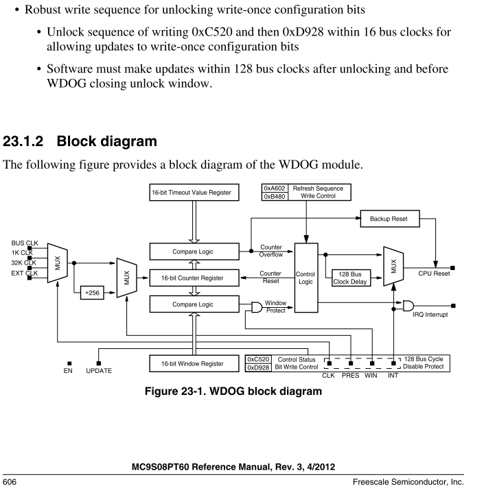

I haven't checked but it's possible that you are not using the correct watchdog timer unlock code(s), as I understand there can be different versions for each S08.

The problem it isn't the value, but the dimension of WDOG_TOVAL, for takes effect it is necessary to write all register, and I wrote only the low of  WDOG_TOVAL
Thanks for making me understand the differences and bringing me on the right track.
