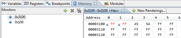

I am using the examples from AN4570. The example "EEPROM_ProgramUpto4Bytes". I am writing to location 0x3100 and the data is visible when using the "Memory Monitor" but when the chip is reset the data goes back to 0xFF.  I am erasing before writing and the functions are returning success. I am assuming that the BUSCLK is the 4MHz crystal that is clocking the chip (the datasheet is vague about this) so I have set FCLKDIV to 0x03 (3.6 to 4.6MHz). Any ideas on what I'm doing wrong?

The actual issue I was having was that I could not prove that the EEPROM as persistent between boots. I was using the debugger to determine the values in EEPROM.  When you run a debugging session it erases all flash and EEPROM before it programs. I found a way to make codewarrior skip erasing EEPROM.
While doing this I found something that works!
Open "Debug Configurations..." from the "Run" menu item then "Edit" the "Connection". Click on the "Advanced Programming Options" and in there you will see that it is already populated with the addresses of the EEPROM (0x3100 to 0x313F)

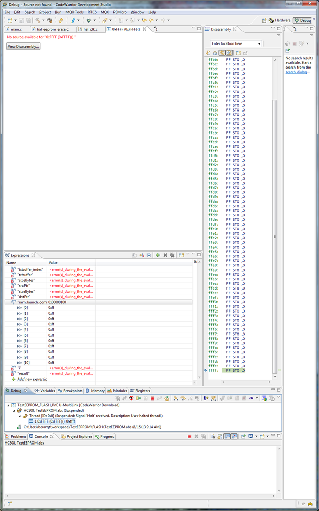

Also, I am having problems with the debugger (https://community.freescale.com/thread/310757). This kind of issue keeps coming up. While I'm working on this code it will go off and say that it can't show the disassembly for the current instruction. Sometimes it just completely loses connection to the micro and needs to be started again. Any idea why I can't write the eeprom and why the debugger is doing this?

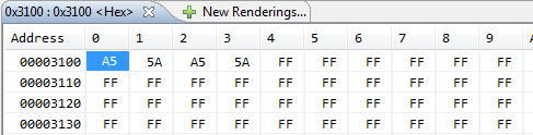

I have ran your code on my PT60 TWR board - it is failing in hal_clk_init function,
I have excluded
// ICS_OSCSC_OSCOS= 0x01; // Output Select (1 Oscillator clock source is selected)
// while (ICS_OSCSC_OSCINIT == 0); /* waiting until oscillator is ready */
and flashed those 4 bytes into EEPROM space 0x3100
then I did a POR (I have disconnected the board completely to be sure)
and launched the code again with breakpoint at the beginning of main
the content of EEPROM is correct
this ICS setup seems to be the source of an issue of your debugger too.
I hope this will help

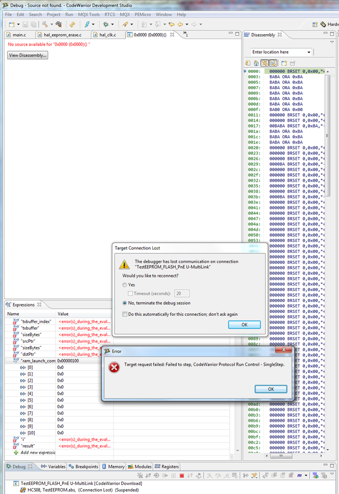

I did comment out those two lines but my experience was very different.
Debug with no breakpoints.
Then I get;
Then I step into ~7 times and then I get
This is essentially the same as before. The only difference is that if I put a breakpoint on the line after the eeprom_init the debugger never reaches the breakpoint (same error as before) when I have those lines commented out. With those lines the debugger does reach the breakpoint.

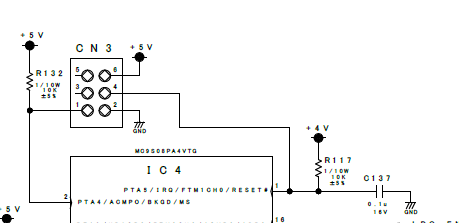

This is the debug circuit on the board I am using.
The datasheet does not have any pull-ups or a capacitor. Could this be the source of the debugging issue?

well, Reset is connected according ref manual fig. 2.5, that is correct. BKGD/MS pin pullup is not recomended anywhere however it has internal one, so the additional pullup hooked externally should not cause any issue.
I would point you to errata document, it is available on S08P product summary page, there are 2 for different masks of PA4, so choose the correct one.
there are few issues and their workarounds  for Flash and Debugging mentioned
the raw code of yours works, this is proved by my last trial, so issue might be with missing workaround for your exact device (mask)

why is reset tied to 4V instead of 5V?

I didn't see that 4V when I posted it. I can assure you that this board is not wired that way.
