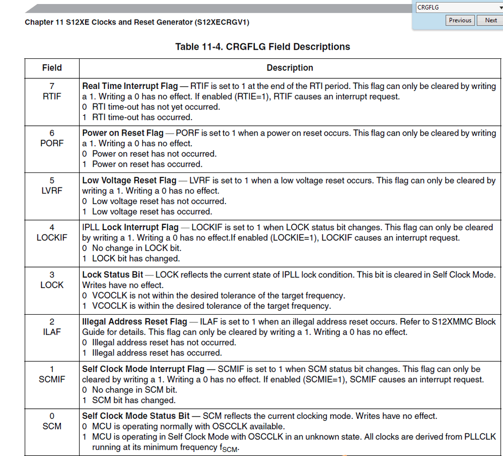

     Recently I use S12XET256 to develop a controller, but I  failed to find the COP Reset Flag, could someone tell me the register name? thanks very much. My email address: collins.ke@irco.com.
